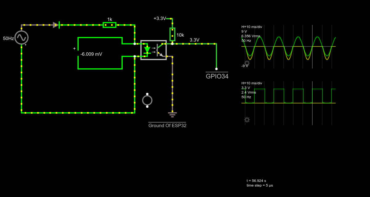

After so many issues with esp32 as a frequency counter , I decided to put the issue here ..hopefully I'm wrong .
So , during making this project ..we needed the addition of frequency counter ..and we started noticing erratic behaviour from esp32
I'm the software guy , so I thought something is not right with the custom board
The hardware guys are convinced that it's all about the ESP32 itself , and it's timers .
so in my last attempt I decided to make a separate circuit to test this FC thing in isolation of everything else .
to see the circuit , go to the following link
http://falstad.com/circuit/circuitjs.html
and from File -> Import from text and copy the following and paste it there

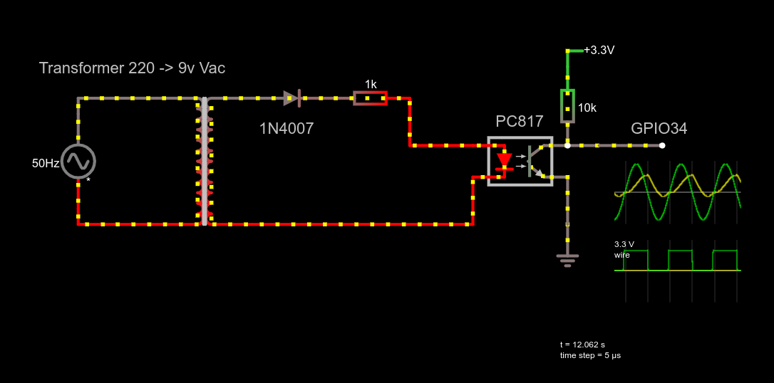

A/C is a Transformer from 220v to 9v
The Opto Coupler is PC817 or EL817
Diode is 1N4004 but on my circuit i'm using 1N4007
again I'm the software guy , but this circuit works perfectly with arduino uno , the only difference is we pull high to 5V instead of 3.3v
with ESP32 , it gives very un stable readings .

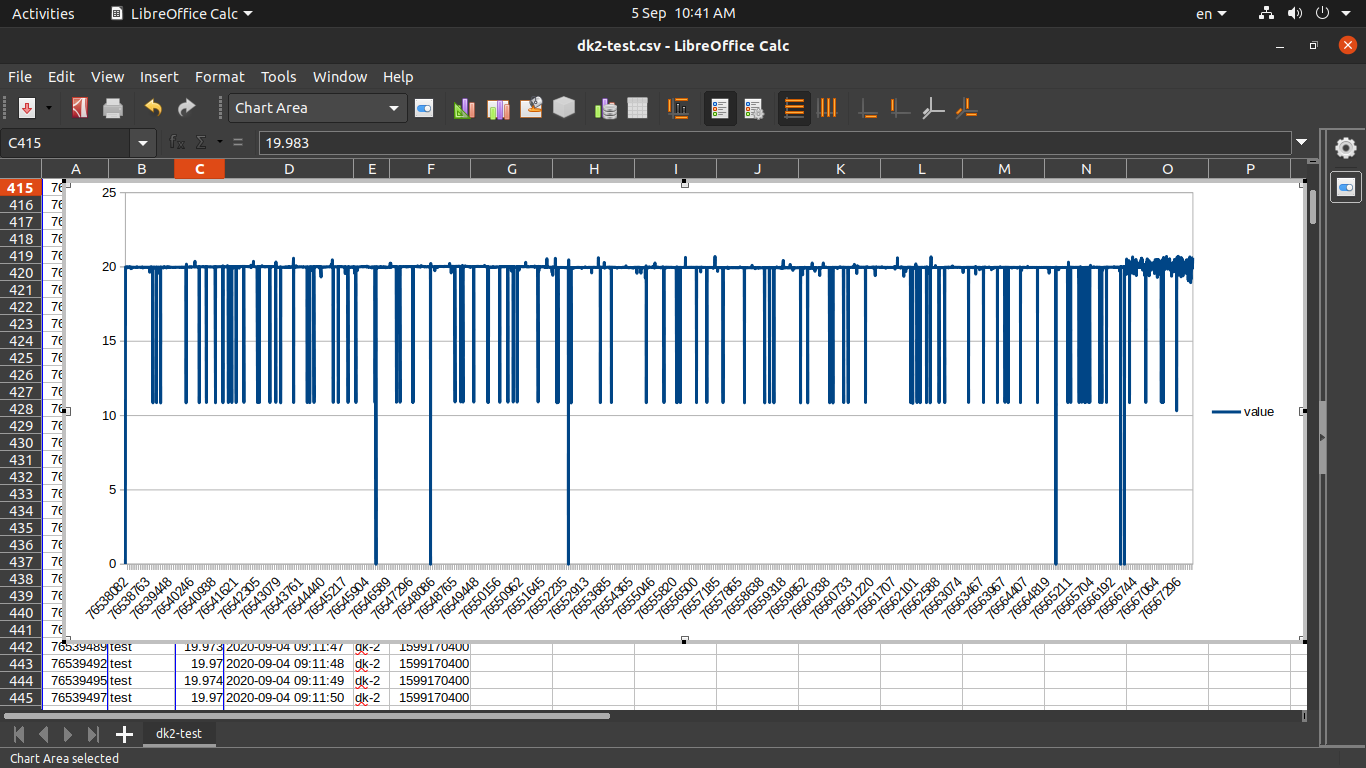

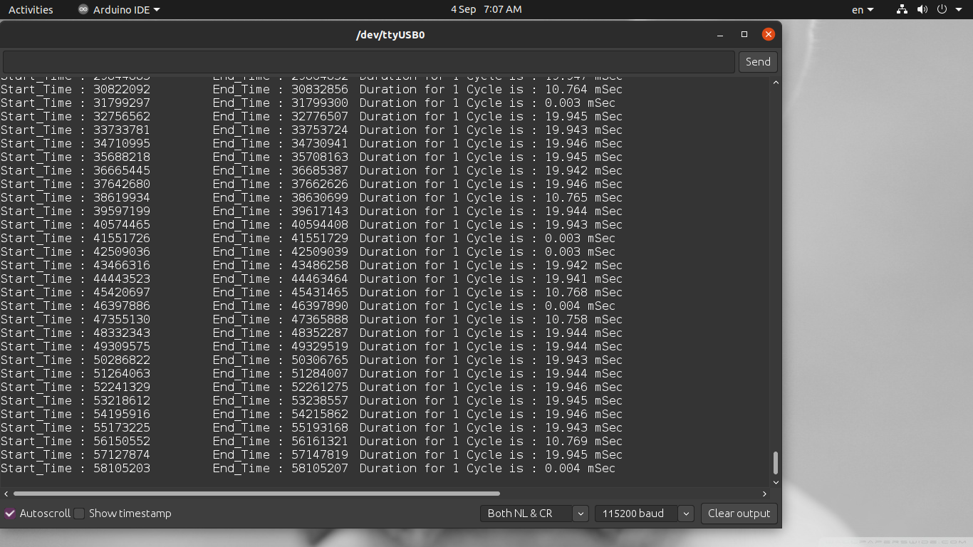

@woodmna69
The complete circuit
The Data analysed
Screenshot from 2020-09-05 10-41-34.png (123.02 KiB) Viewed 15270 times
The Zeros and Half Values
Screenshot from 2020-09-04 07-07-08.png (273.69 KiB) Viewed 15270 times
Looks like no one is taking this seriously
I usually code IDF not Arduino core , Only this project needed Arduino because of the many libraries we use
I'm now totally convinced it's a hardware issue
testing with Arduino , I was measuring the wavelength every 13 mSec , Rock Solid ..not a single faulty reading , but with ESP32
I can never eliminate those zeros and half values
Also I don't understand when people say , interrupt .. the ESP stack .. freeRTOS , the Code in reality is freeRTOS and this is the bare minimum to illustrate the issue
btw , The original circuit is an Op Amp circuit .. not the Opto-Coupler like above
Looks like for a FC that is complying with a Government regulations , I should think of adding something like attiny85 , pretty sure that will be accurate enough to meet the requirements
