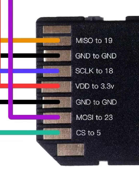

I use SPI and SD respectively according to some online example guidelines_ Connect my esp32 and SD card in MMC mode, and SD card can work normally in SPI mode_ Test program, but SD_ After MMC connection, "card mount failed" is always prompted. Then I try to pull up gpio2,4,12,13,15 and change it to "sd_mmc.begin("/sdcard", false)", but the result is still "card mount failed". Can someone help me? I want to use SD_ MMC way, because I use SPI for RFID card reading. Thank you very much!

  1. E (42) sdmmc_common: sdmmc_init_ocr: send_op_cond (1) returned 0x107
  2. E (43) vfs_fat_sdmmc: sdmmc_card_init failed (0x107).
  3. Card Mount Failed

Jachin
Posts: 11
Joined: Fri Mar 18, 2022 9:06 pm
Re: SD mount problem
Postby Jachin » Tue May 10, 2022 12:12 am
rpiloverbd wrote:
Mon May 09, 2022 3:26 pm
Have you tested the SD card breakout board separately? With an Arduino?
Thank you for your advice. I use the SD Adapter and connect it with ESP32 like this, but it can not run SDMMC_Test successfully.
I tried to change the connect way to use the SPI method and it can run SD_Test.ino successfully. Could you help me to find out the problem, thank you very much.

Postby Jachin » Tue May 10, 2022 3:25 am
E (15527) sdmmc_cmd: sdmmc_read_sectors_dma: sdmmc_send_cmd returned 0x109
E (15528) diskio_sdmmc: sdmmc_read_blocks failed (265)
E (15528) vfs_fat_sdmmc: mount_to_vfs failed (0xffffffff).
Card Mount Failed
Sometimes, it report error log like this. I don't even know why show a new kind error
