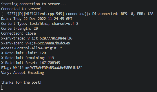

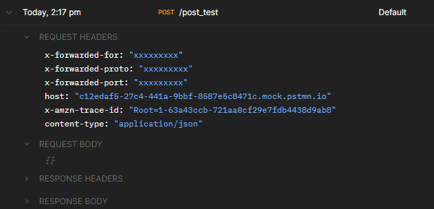

Before trying to implement the sequential read I tried to port my code over to WifiClient.h but after 3 days of trying everything there still is no content in the body of the request. Can you see where my issue lies (im highly suspecting the \n's and \r's)?
(The first part hasn't changed at all, just the part after "WiFiClient client")
Code: Untitled.js Select all
  WiFiClient client;
Serial.println("\nStarting connection to server...");
if (!client.connect(httpHost, 80))
Serial.println("Connection failed!");
else {
Serial.println("Connected to server!");
client.println();
client.println();
client.println("POST " + String(httpPath) + " HTTP/1.1");
// Make a HTTP request
client.println("Host: " + String(httpHost));
client.println("Connection: close");
client.println("Content-Type: application/json");
client.println();
client.print("{\"DeviceId\":\"");
client.print(deviceId);
client.print("\",\"Data\":\"");
client.print("lorem ipsum");
client.print("\"}");
client.print("\r\n");
while (client.connected()) {
String line = client.readStringUntil('\n');
if (line == "\r") {
Serial.println("headers received");
break;
// if there are incoming bytes available
// from the server, read them and print them:
while (client.available()) {
char c = client.read();
Serial.write(c);
Serial.println();
client.stop();
delete [] fileBuffer;
Esp32 serial readout:
Request recieved by Postman's mock server (internally created post requests are successfully transferred):

ISSUE IS SOLVED, the request just needed a Content-Length header haha. A 1 week brain melting session finally resulted in something.
Thanks a lot for your advices @lbernstone, hope you have a nice day.
