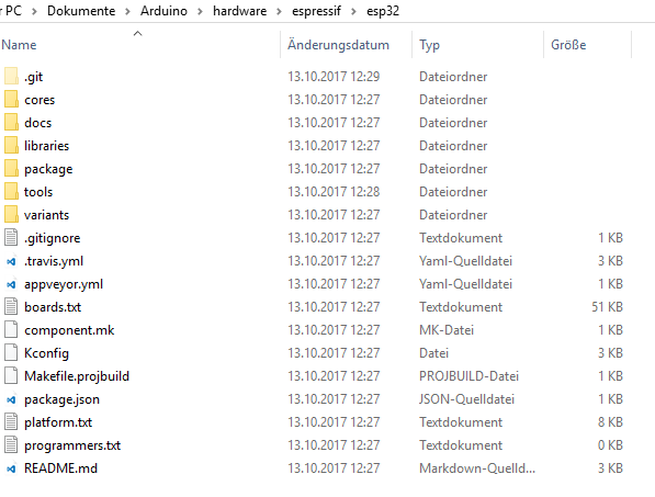

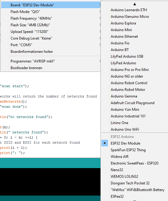

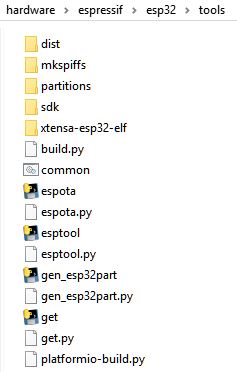

I have the same system configuration and found that there is no Installation of drivers on my system. (WIN10/64BitPro)
If i plugged in the ESP32 Dev Board, a new COM Port comes up. In my case: COM5 but that could differ.
I followed also the instructions on Github and in my Arduino IDE i have the new boards. See attachment.
Then i loaded a sketch from the libraries/wifi directory, compiled and uploaded the sketch without any modifications.
I had only to choose the right COM Port.

I think at first the needed boards must show up in your IDE.
