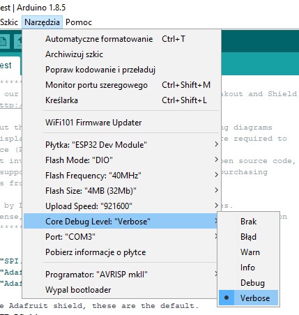

chegewara
Posts: 2238
Re: GATT_READ_NOT_PERMIT on BLE Characteristic Read
Postby chegewara » Tue Feb 20, 2018 8:43 am
As you can see from logs this does not work:
  esp_log_level_set("*", ESP_LOG_VERBOSE);
  esp_log_set_vprintf(print_F);
You need to change logging level in arduino-ide. Code you pasted here seems to looks fine, but its a small chance that BGM requires encrypted connection (even if so GATT_READ_NOT_PERMIT shouldnt be a problem) or something and without more detailed logs i cant tell you more.
Tom_Koller
Joined: Thu Feb 15, 2018 4:14 pm
Postby Tom_Koller » Tue Feb 20, 2018 10:21 am
Thanks for the Log level settings here is the verbose log:
