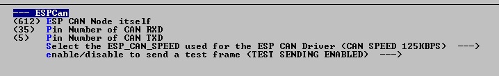

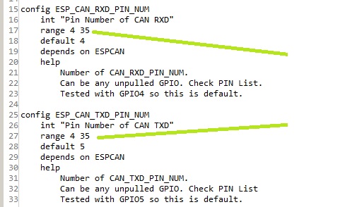

cause the driver pack is created on the GPIO4 and GPIO5 successful
you have to expand the RANGE in the "Kconfig" file under the CAN Component by self
example Olimex use
Rx GPIO35
Tx GPIO 5
save it and run menuconfig on your favority way like you did in the past.
you see now CAN under component config,
setup your node, Rx, Tx, Baud, and if you want use the CONFIG Define example send test frame, you can set here and you have then a possible way in your code to use
you can start now a test compile.
this must compile without problem.

if you use the CAN Demo so be sure, there are small changes need
cause the the structure of CAN Demo was that the driver is in the project and not as component,
so this can be the reason why your compile fails.

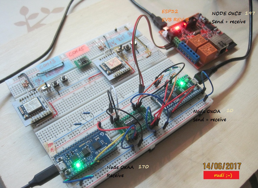

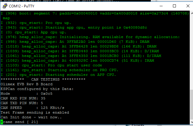

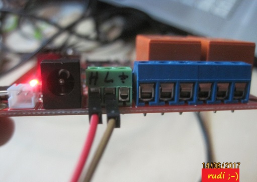

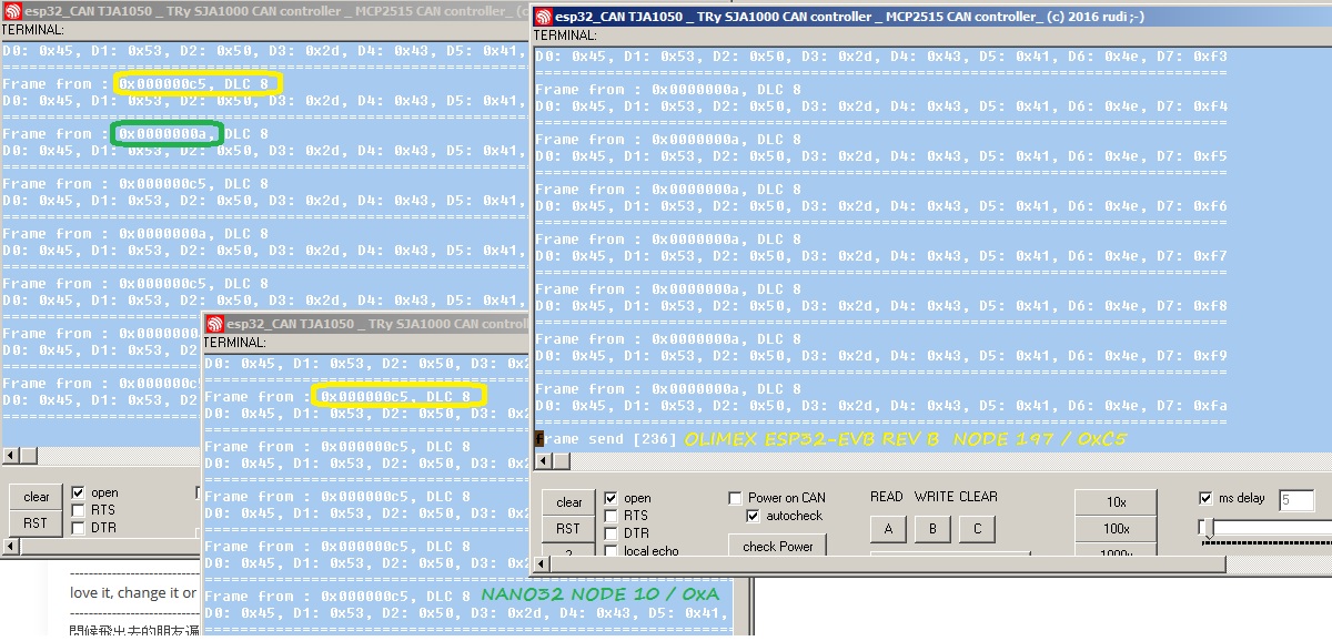

here we are vid part 2
CAN Demo based on the CAN Driver Pack
Rx = GPIO 35
Tx = GPIO 5
Baud = 125K
Node = 197 ( 0xC5 )
visit github ESP32DE
rudi
Rx = GPIO 35
Tx = GPIO 5
Baud = 125K
Node = 197 ( 0xC5 )

Re: ESP32 CAN demo on Olimex ESP32 REVB compile issue
Rudi,
Thank you so much for this,
I tried out your demo code and it worked flawlessly. It looks like it is sending out those test frames fine, I am going to bring my board into work tomorrow and test it on our CAN baud tester but by all acounts it looks like i should be able to continue with my project. Thank you, you really went above and beyond what was needed all for a stranger.
Many thanks
Rocketman
Many thanks
Rocketman
