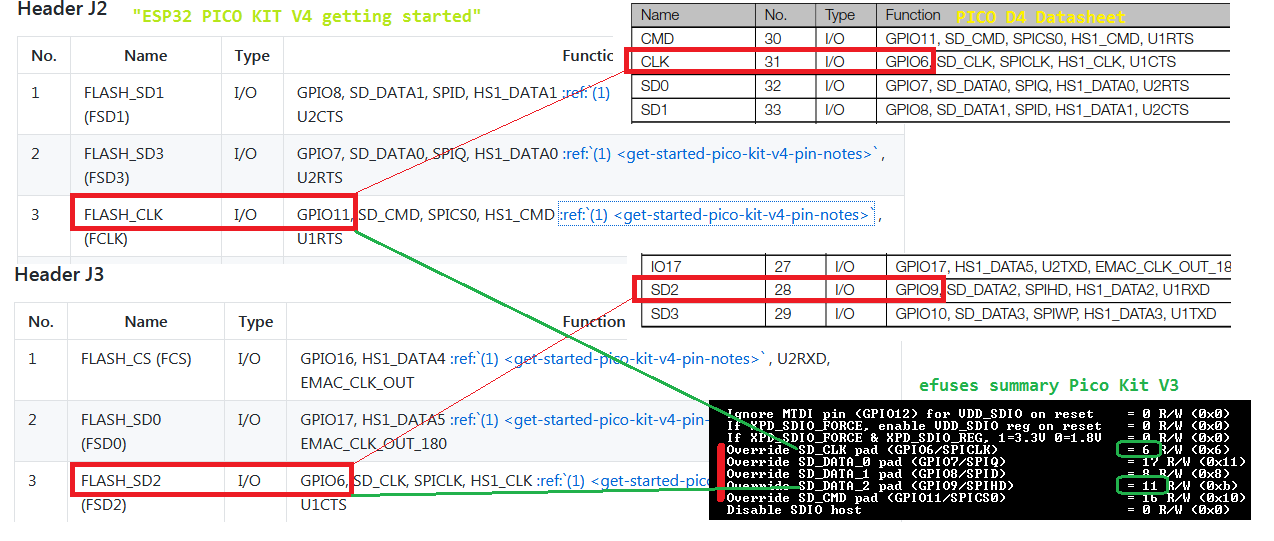

Postby rudi ;-) » Sun Dec 10, 2017 2:04 am
hi ESP_ team,
was there a change in SIP design?
why i ask:
i saw this merge last hour and remember me, that we had in
Pico D4 V3 & V2
IO11 for Flash_SD2
IO06 for Flash_CLK
the merge is now swapped version (again)
IO06 for Flash_SD2
IO11 for Flash_CLK
i have just in time no V4 in the hand to test ( hope i will get before xmas comes ) ,
which pins are really used in the SIP so i ask

Postby rudi ;-) » Sun Dec 10, 2017 2:37 pm
PICO D4 V3 Board efuses summary
PICO KIT V4 Getting Started and Pin Description
PICO D4 Datasheet and Pin Description
Flash_SD2, Flash_CLK changed and swapped in Pico Kit V4 now ? or mistake ?

hi ESP_ team,
why i ask:
Pico D4 V3 & V2
IO11 for Flash_SD2
IO06 for Flash_CLK
IO06 for Flash_SD2
IO11 for Flash_CLK
happy new year!

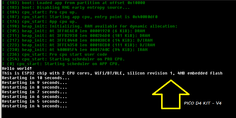

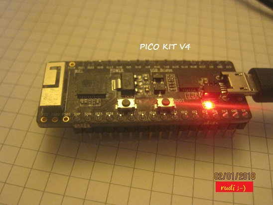

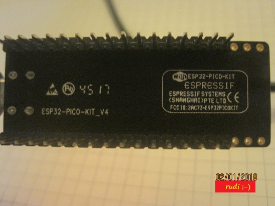

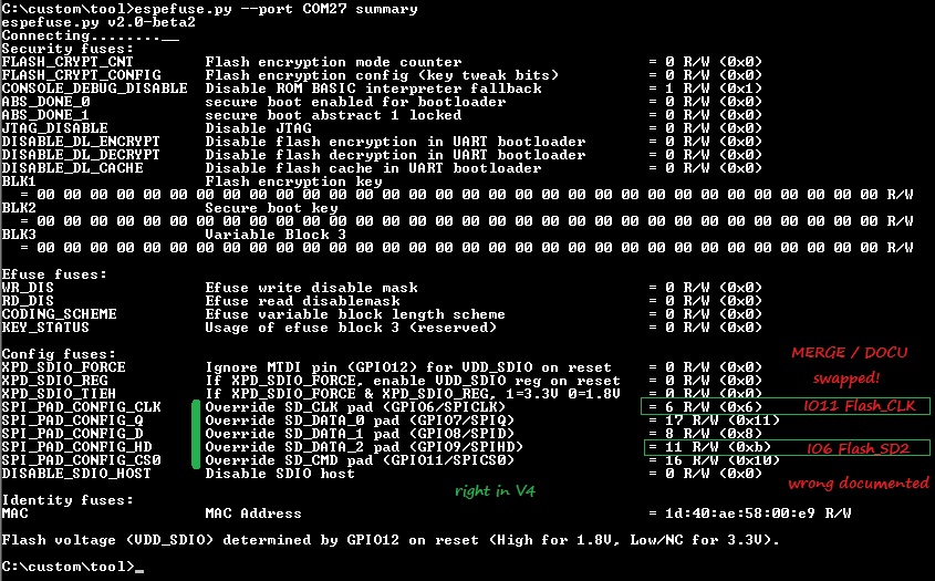

now i got today from DHL my ordered bought "3 Week Parcel" ( hoped for get it before christmas but get it today )
but now i have V4 in the hand and yes - the your docu merge is wrong - it's swapped now again - .
Pico D4 V3 & V2 has
IO11 for Flash_SD2
IO06 for Flash_CLK
and
Pico D4 V4 has
IO11 for Flash_SD2
IO06 for Flash_CLK
and not
IO06 for Flash_SD2
IO11 for Flash_CLK
i think - the docu / code merge is wrong.

Posts: 1756
Re: ESP32 Pico Kit V4 ./. V3 & V2 swapped pins Flash_SD2, Flash_CLK
Postby rudi ;-) » Tue Jan 02, 2018 6:43 pm
btw:
Pico D4 Kit - V4
382017
is Rev1 - very welcome!
now it's time for the ultimate DOOM on Pico D4 Kit test as the Standard PSRAM test

Hi rudi ;-),
Happy new year!
This is a good catch.
Thank you for pointing it out with detailed documentation and persistence!
I will submit an update to the merge request you mentioned.
Sorry for not fixing it in the first place.
