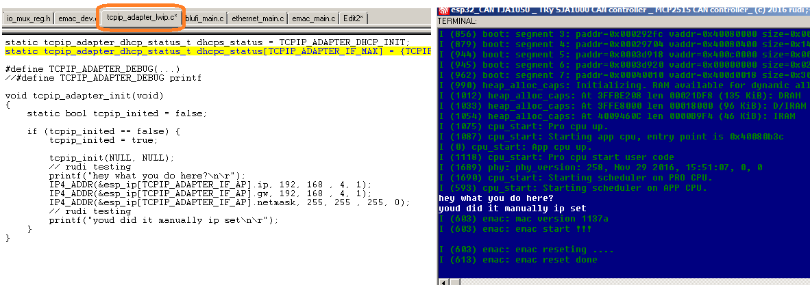

a second thing (puzzled):
the ethernet example calls tcpip_adapter_init();
https://github.com/espressif/esp-idf/bl ... ain.c#L164
this calls
https://github.com/espressif/esp-idf/bl ... lwip.c#L48
and there we address to ap ( btw ap without WiFi enabled brings undefines ? )
missing the "TCPIP_ADAPTER_IF_ETHERNET" and IP Setting, where we get our "ETH" IP Address ?

Postby Angus » Fri Feb 24, 2017 4:36 am
At the moment, to use ethernet WiFi must be enabled in the configuration. This is a bug, and there is a fix currently being reviewed and tested. Once that is merged, it will be possible to enable Ethernet only.
In the meantime, if WiFi is enabled in configuration but unused (ie no esp_wifi_start(), etc.) then the firmware will be larger than necessary in flash but the runtime overheads are extremely small.
Regarding using Ethernet & Wifi simultaneously, this is possible. I put this reply into a new thread on the SDK forum: https://esp32.com/viewtopic.php?f=13&t=1274
