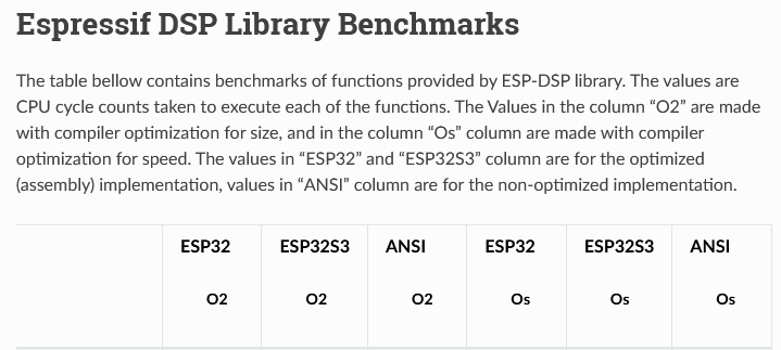

Some DSP related benchmarks of ESP32-S3 are available here: https://docs.espressif.com/projects/esp ... marks.html.
cheers,
"The Values in the column “O2” are made with compiler optimization for size, and in the column “Os” column are made with compiler optimization for speed."
O2 Os size/speed | Typo/swapped?
-Os

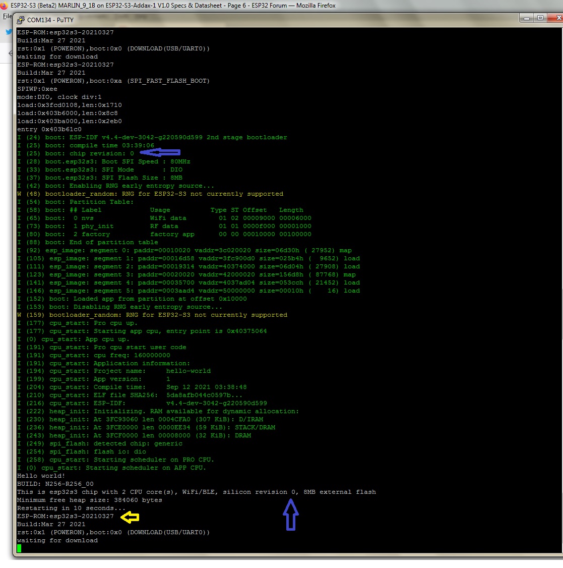

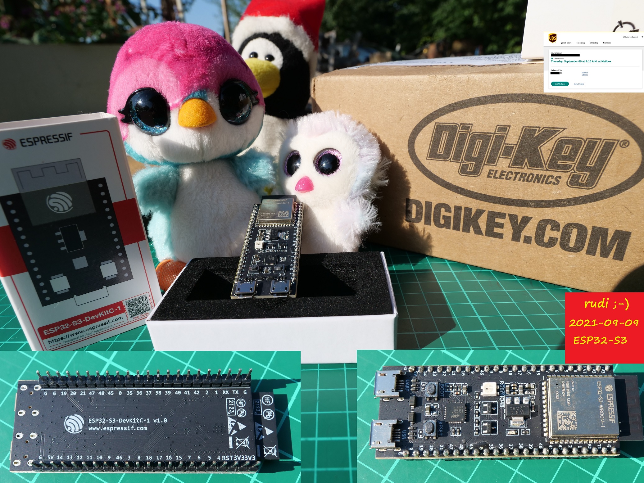

Hi Folks,
ESP32-S3-DevKitC-1 with ESP32-S3-WROOM delivered from Digikey today. :D
and now on Desktop.
bootlog
FYI:
Digikey had the DevKits in stock and you had to be quick.
I managed to secure a handful and bought it; the shipment was very fast and arrived today. Happy happy -
:mrgreen:
Attached 3 Picture ( only 3 allowed )
so - Edit: Add a Pin Layout Link to my Twitter Account .. PIN LAYOUT
ESP32DE
ESP32-S3-WROOM-N8
ESP32-S3-WROOM LIST
ESP32-S3-BOOTLOG

Just to be careful, that these are from before the latest ECO of the silicon :)
This part is an engineering sample and is not fully tested. This part should only be used for functional evaluation and proof of concept, not for production or end use.
yes - they are engineering sample from Digikey/Mouser -
yes - the newer batch from espressif are newer one - with ECO patch. :)
Datasheet comes public out do Oct 28 from hearing
edit: added boot from hello_world_S3_Rev_O
BUILD: N256-R256_00 is my own ID for this ( becomes octal parts )
ESP32-S3-Rev-0
222021
ESP-ROM:esp32s3-20210327
Build:Mar 27 2021

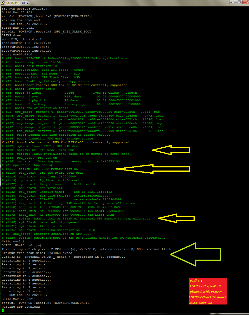

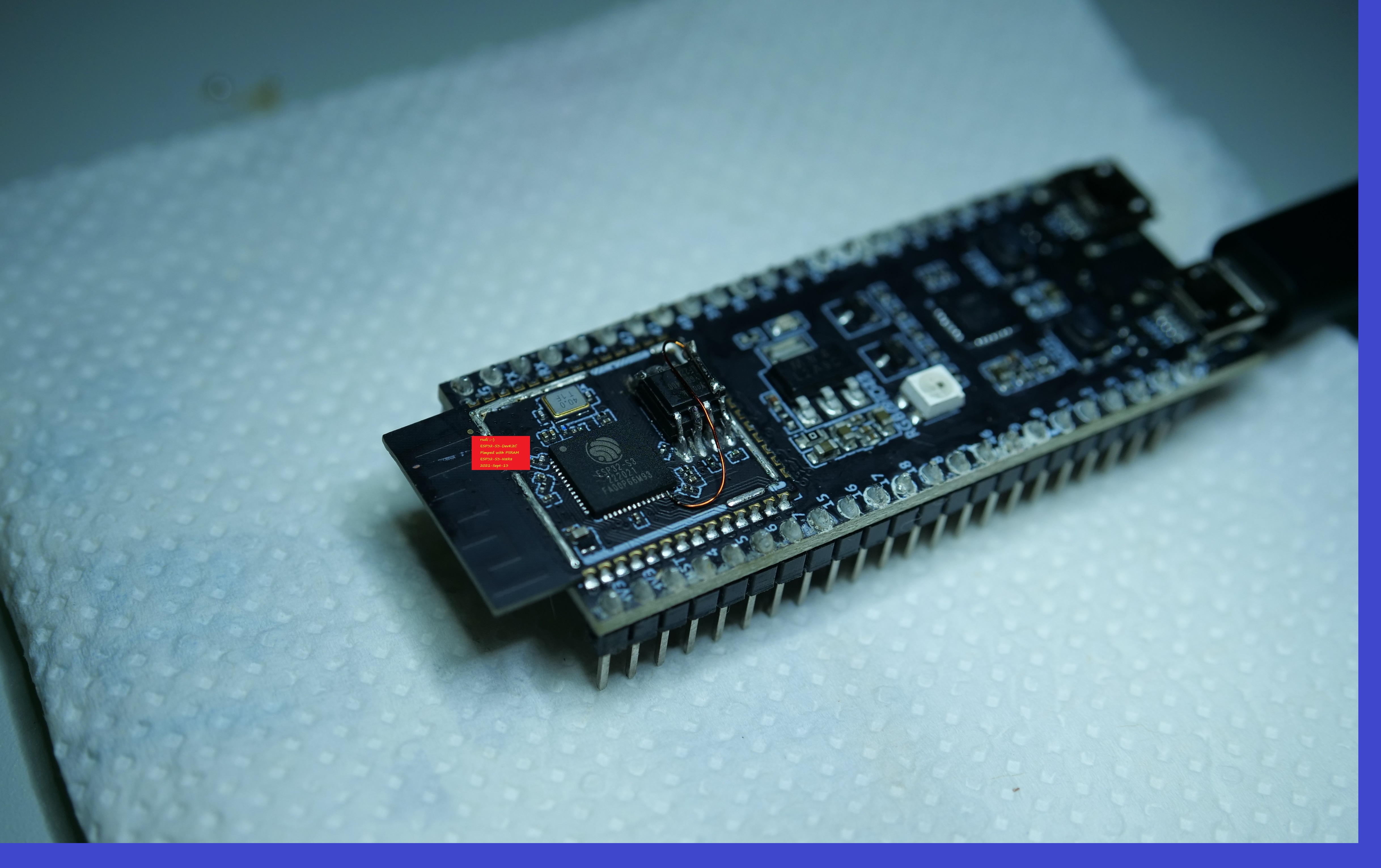

was only little careful and broke the Board _
pimped ESP32-S3-DevKitC-1 (ESP32-S3-WROOM ) with external psRAM :mrgreen:
Minimum free heap size: 8734063 bytes
ESP32-S3-DevKitC
Bootlog ESP32-S3
with 64Mbit ext. psRAM
ESP32-S3-DevKitC
pimped with external psRAM

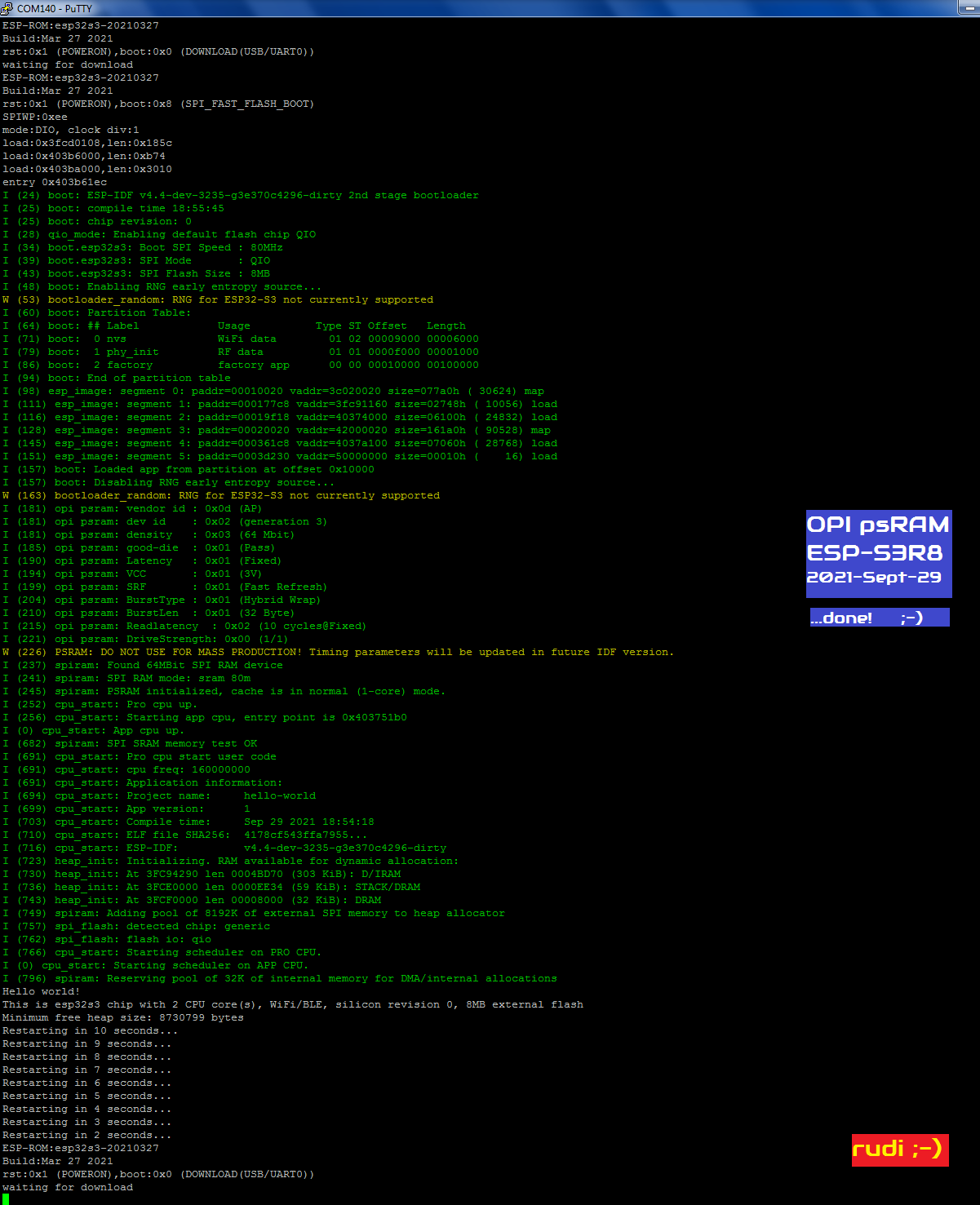

ESP32S3N8R8 Octal psRAM
Postby rudi ;-) » Wed Sep 29, 2021 5:46 pm
You didn't break it, just upgraded it with 3D-Integrated circuit technology :mrgreen:
Now THAT is development 8-)
Be careful posting it. Espressif might steal the idea to have better space budget on the WROOM modules :D
:) i work on that :) wait for the final
but first take a look to that bootleg - you find here a small difference to the previous post (handmade mod by add psram to flash ),
an AMAZING feature between the lines :)
( zoom example: right click on the picture - open it in a new Tab )
ESP32-S3-DevKitC-1-N8R8
OCTAL PSRAM
Yeap! ESP32-S3-N8R8 is here as a WROOM on the ESP32-S3-DevkitC-1-N8R8
2021-Sept-29 -
@ESP_* Great ESP-IDF Work!!!!!
I noted, that the CLK will change in the future IDF. You can drive it up - 120 MHZ .. 266 MHZ - i am *hw* ready for it. :mrgreen:
