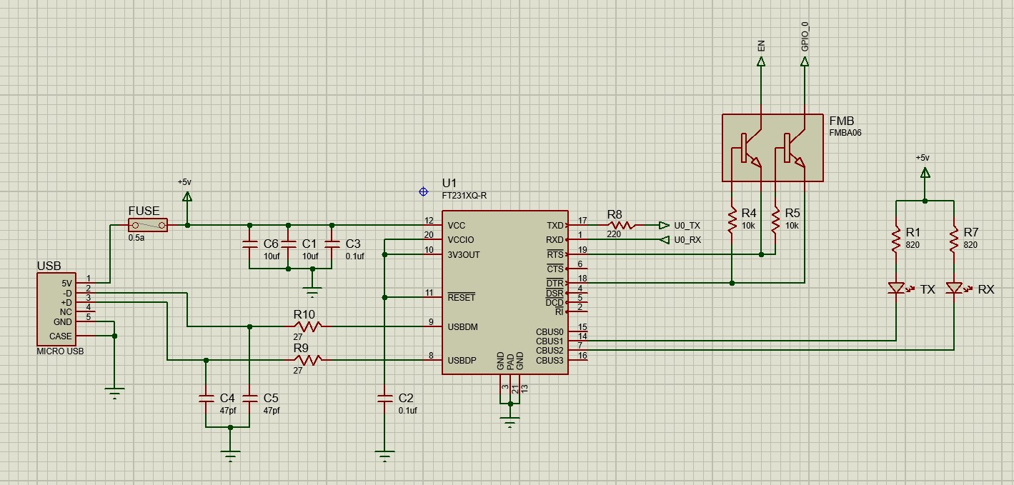

Re: What would I need to enable flashing to a ESP32-WROOM-32
There is more to it than this, you also need to control the EN pin as well.That means pulling both GPIO0 and GPIO2(fixed) low.
To put the device into programming mode you need to pull EN & GPIO0 low. Then release EN, and moments later release GPIO0.
You don't need to fiddle or control GPIO2 at all.
This sequence is explained in the manual.
Yes, you the caps
This is the circuit I use. Mind you what you dont see on there is that there are a 10k pullup on both the EN and GPIO0 lines, along with a 0.1 cap to gnd for each as well.

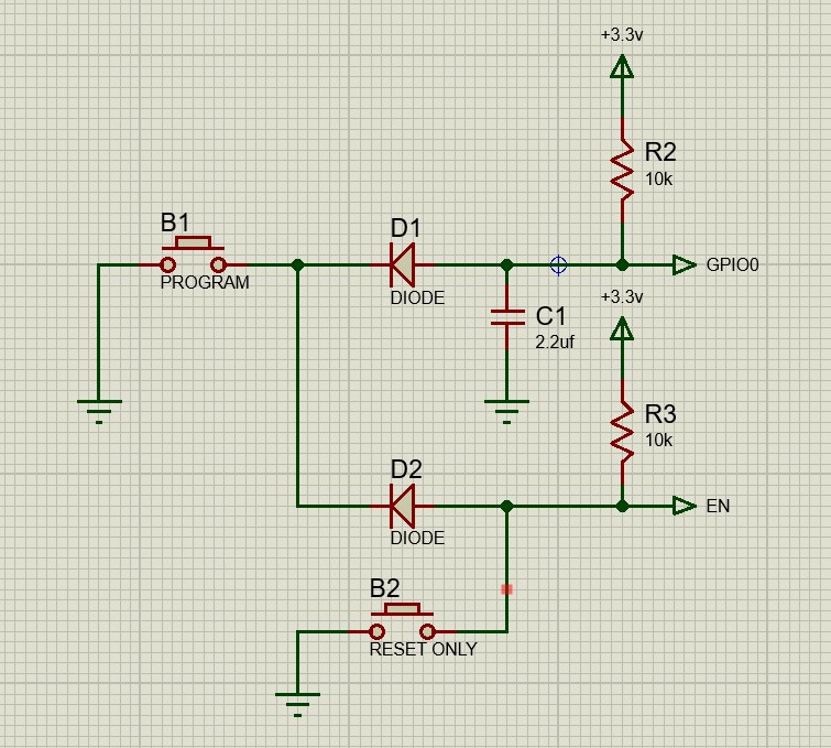

Quickly thinking about it I would do something like this. You might have to play with the cap value to get the timing right on GPIO0In that case, how would you make this sequence of events happen on a PCB?
I can see how that achieves:
But how does it achieve:
-- That happens when I push the program button.To put the device into programming mode you need to pull EN & GPIO0 low.
-- is the 'moments later' part the 2.2uF capacitor C1?Then release EN, and moments later release GPIO0.
yes-- is the 'moments later' part the 2.2uF capacitor C1?
