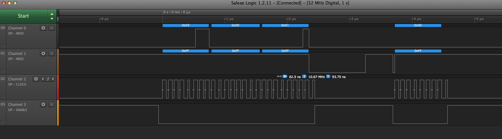

Screenshot 1, 1 byte read. Notice that a dummy had to be sent after CMD+ADDH+ADDL and return last reply (0x20) (Could not attach due to forum limitations rules I guess)

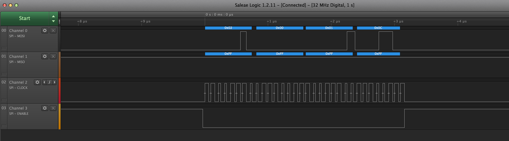

Screenshot 2. A 10,000 byte write to Fram. Perfect.!!!!

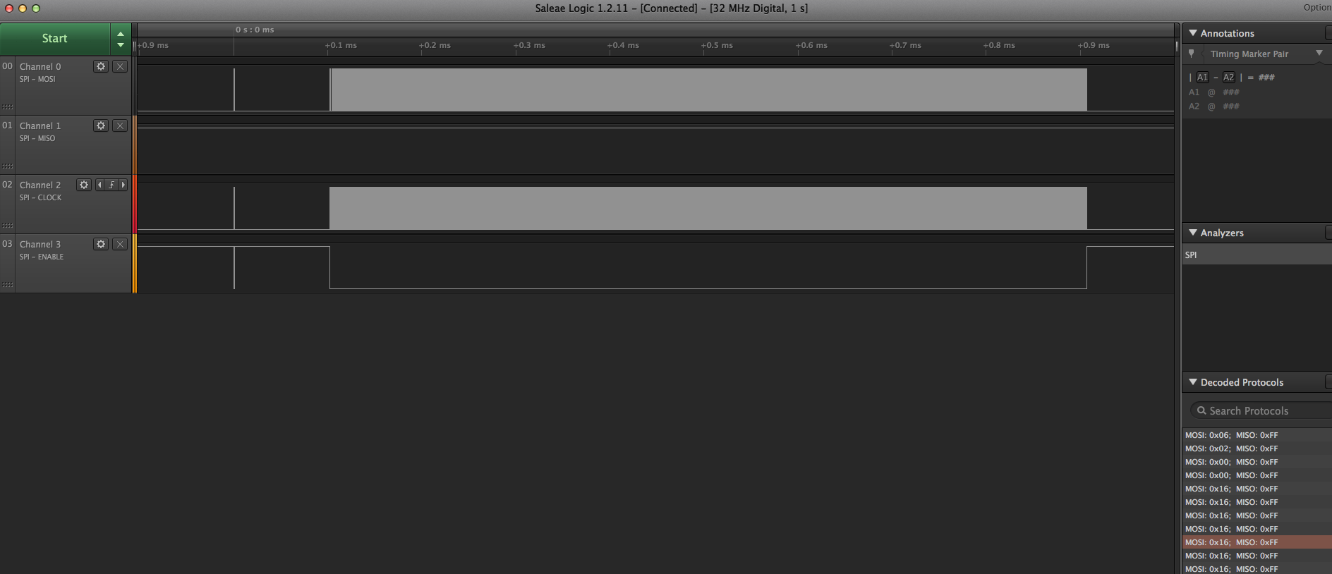

Screenshot 3. A 10,000 read request sending just the CMD+ADDH+ADDL. Stops after ADDL. How to send 10,000 dummies without a malloc?

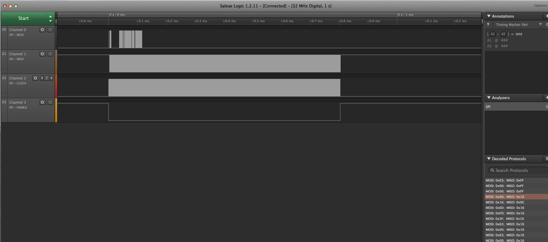

Screenshot 4. A 10,000 read request sending the CMD+ADDH+ADDL+ 9997 dummies from a malloc buffer. Fram sends the 10,000 bytes but the "values" buffer gets only junk. Tried many varieties of buffers, in main app memory, malloc and others with no success.

Are you using half-duplex mode? It seems to me you need to use that. In full-duplex mode (the default) you will always receive data as you send it.

Half Duplex did solve the problem related to the rxbuffer extra bytes! Still, its manageable.

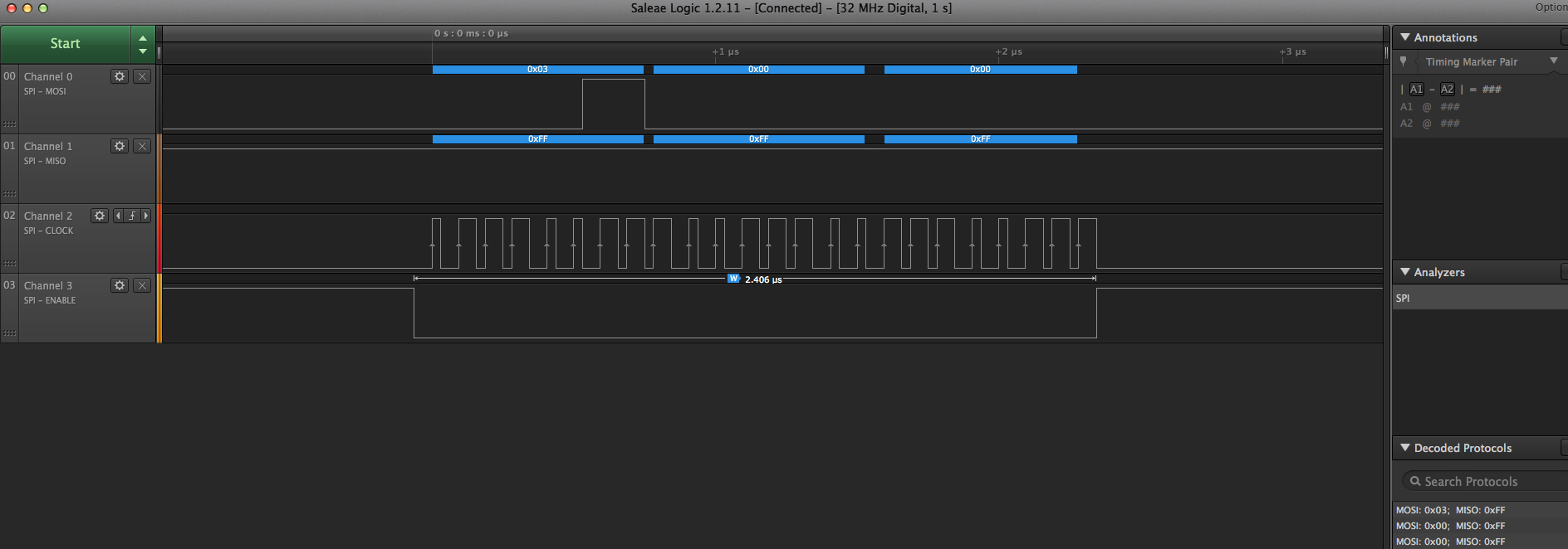

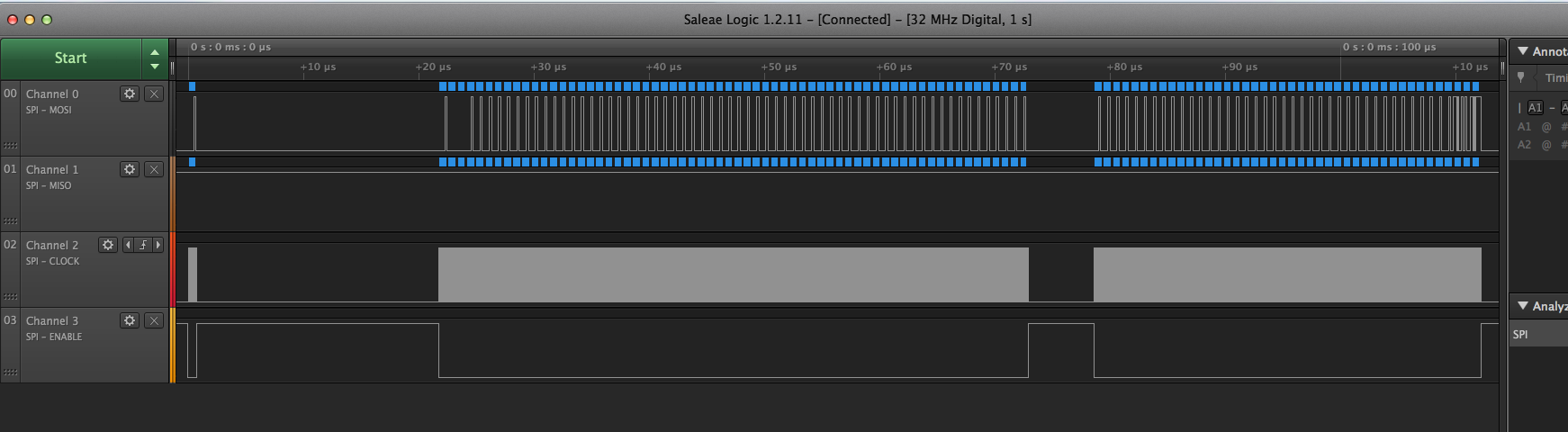

A 1 byte write (actually 4 to the spi) is done correctly (screenshot1). Not so MANY(100) bytes(screenshot2), it drops the CS at some point I don't know why. Same CS drop happens in the Read (1 byte or many) Screenshot 3.

About the CS problem, please try to use "software CS":
spi_nodma_transfer_data will automatically activate CS if it was not activated by spi_nodma_device_select before starting any transmit/receive operation and deactivate it after all transmit/receive is done, the CS will stay active during the whole transaction. It works that way both in duplex and in half duplex mode.
Or you can execute spi_nodma_device_select before the spi_nodma_transfer_data, in that case you can execute multiple spi_nodma_transfer_data and deactivate CS with spi_nodma_device_deselect after the last one.
When using "software CS" CS will always be active between spi_nodma_device_select & spi_nodma_device_deselect. Don't forget that these two functions must always be used in pairs.
spi_nodma_device_interface_config_t devcfg={
.spics_io_num=-1, //we will use "software" CS pin
.spics_ext_io_num=PIN_NUM_CS, //your "software" CS pin
- Posts: 124
- Joined: Tue May 17, 2016 8:12 pm
Re: SPI Master Receive Problems
I think there is Concept problem.
CS must remain low during the TRANSACTION, which in theory is ALL TXbuffer bits + RXBuffer bits. That is, not only during transmission but also IF there is reception. That is why the Write works ok, because we are saying write 4 bytes *8 =32 bits and receive 0 bits TOTAL of 32 bits. But when you read, your say Transmit 3*8=24 bits Transmit (MOSI) and Receive 8 bits (MISO) TOTAL of 32 and THEN pull CS high, not after 24 txbits are sent. Apparently this is the case on hand.
I guess that the receive bits required will be read from MISO line in requested bits(rxlength) and could be that the MISO lines is inactive and will send back 0XFF per byte requested (MISO line is pulled high by definition). This you can see in the Logic Analyzer if you disconnect the MISO line for example.
So, in theory, a HALF DUPLEX write cmd (1 byte) is CMD+ADDl+ADDH+VAL would be 32 bits TOTAL to tx(32)+rx(0). A Read (1 byte) is CMD+ADDL+ADDH(24) and then read byte (8) from the MISO line TOTAL 32.
Does this make sense to you or am I missing something?
Your suggestion means that the TRANSMIT (spi_nodma_transfer) routine is not really an atomic one(TX+RX) and we need to be monitoring the spi low level routines , am I correct? Thanks again.
Regards.
Regards.
Sorry about the mess with transaction/transmission usage. I've edited the post to be more clear.
The problem exists only when using the hardware CS (.spics_io_num > 0), because then the spi hardware activates/deactivates the CS. I'm always using the software CS (.spics_io_num = -1 & .spics_ext_io_num=MY_CS), that way I have more control over CS. You do have some delay between CS activation and spi CLK start, but when transfering large amount of data it is hardly the problem
