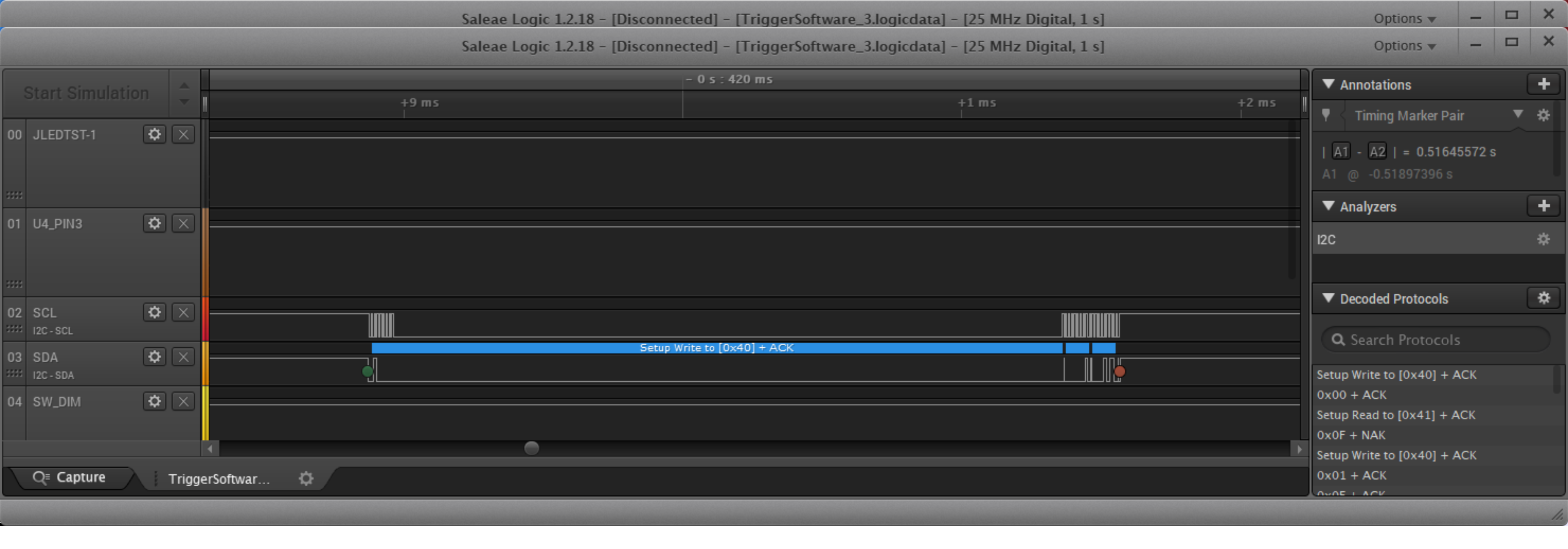

Enclosed is an I2C trace. The trace is I2C legal & shows a GPIO write.
The trace is odd though as there is a long > 2 mS pause between address and register (1st and 2 byte).
Why would that be so?
I have not dug deep into the driver but would imagine that I2C has a FIFO and that FIFO is loaded within a critical section.
If no FIFO then perhaps from an ISR. So why such a long gap.

Hi Peter,
I've added an ID to the topic as we're tracking this internally. I have a few questions to help us debug:
- Is the ESP32 acting as the I2C master or the slave in these examples? I wasn't certain from the description so far.
- Can you please give an example of the on-the-wire I2C protocol, and an example of the kind of corrupt result which you get instead of the correct result?
- Is there any correlation between the 2ms gap and the corrupt results, or is this gap seen on all I2C operations (correct and corrupted)?
- Is it possible to post any code snippets to show how the I2C driver is being configured and used, please?
- Is anything happening in the app firmware that might delay interrupt processing, for example writes to internal SPI flash?
- If you add the ESP_INTR_FLAG_IRAM flag to the intr_alloc_flags parameter passed when registering the I2C driver, does the 2ms delay improve and/or the problem resolve?

1) I2C master
2) The corruption is on a 1 byte I2C GPIO read cycle (W0x40 0x01 R0x41 0x??), rxBuffer[0] = corrupt
GPIO read is every 50mS. There may also be a GPIO write every 50mS from another thread although corruption does not seem related.
3) The clock stretching is occasional as are the corruptions. It is not clear if there is a connection between the two.
The device is configured as low nibble output, high nibble inputs. The corruption generally shows as 0xD4 when 0x8F is expected. I have seen 0x00 when 0x?f is expected.

1) I2C master

@PeterR
It doesn't make sense that the CAN driver would cause a 2ms block as the CAN driver ISR doesn't infinite loop anywhere. The only loop that occurs is the clearing of the CAN RX FIFO. In the worst case scenario where the CAN RX FIFO as completely overrun, the driver would simply clear the CAN RX Buffer 64 times (which is the max message count the CAN peripheral can record), so at most it would be (64 x 13 = 832 bytes to read). At an APB bus of 80MHz, that should theoretically take 10us. Given the other parts of the CAN ISR, my guess would be that the CAN ISR should not exceed a few hundred microseconds.
I'm wondering if this could be related to the I2C stuck bus issue (see 680, 922, 2494. It could be that the I2C is the one that's actually prevent the CAN driver ISR from running in time.
The other scenario could be some hardware issue where the pins used for CAN, ethernet and I2C are interfering with each other. The following information would be useful.
- To eliminate the ISR block theory, you could try install the CAN driver ISR to the core opposite of the I2C ISR. Simply run the CAN driver install function in a task pinned to the other core, and the CAN driver's ISR will run on that core. This way the I2C ISR and CAN driver ISR would not affect each other.
- Maybe this is also some form of hardware issue? Which GPIOs are you using for CAN, Ethernet, and I2C. Could it be possible that there would be some power issue (i.e., maybe the pins share a common ground of some sort).
- What I2C Slave is the I2C Master reading from? Does the Slave datasheet specify a maximum clock stretching period? Is the the slave that's actually keeping the SCL line low?
