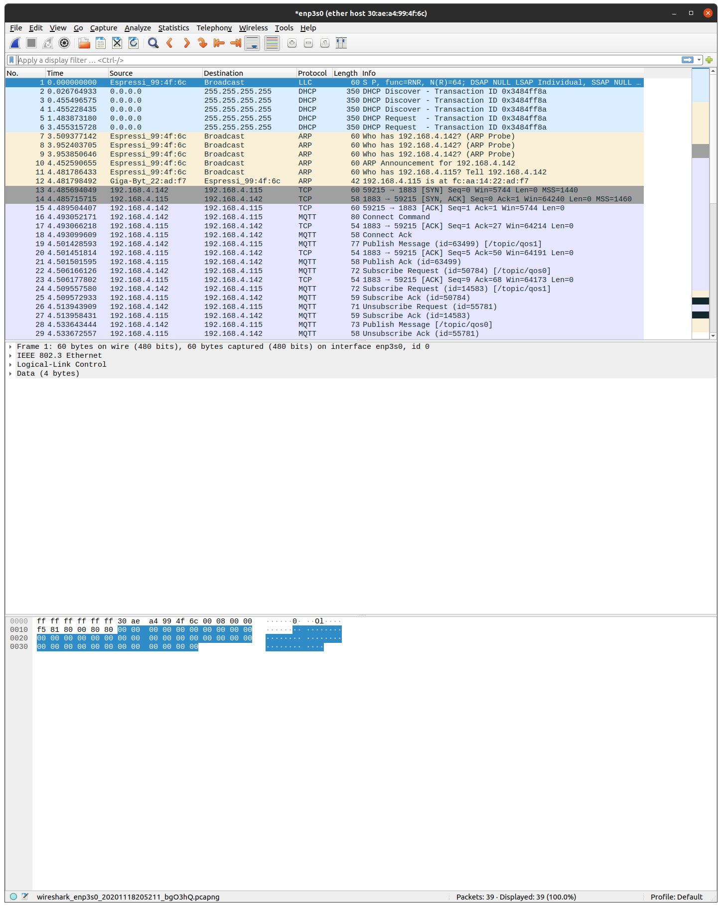

When I compile and run the esp-mdf/esp-idf/examples/protocols/mqtt/tcp/ example, everything works as expected using esp-mdf master. I see the following traffic:

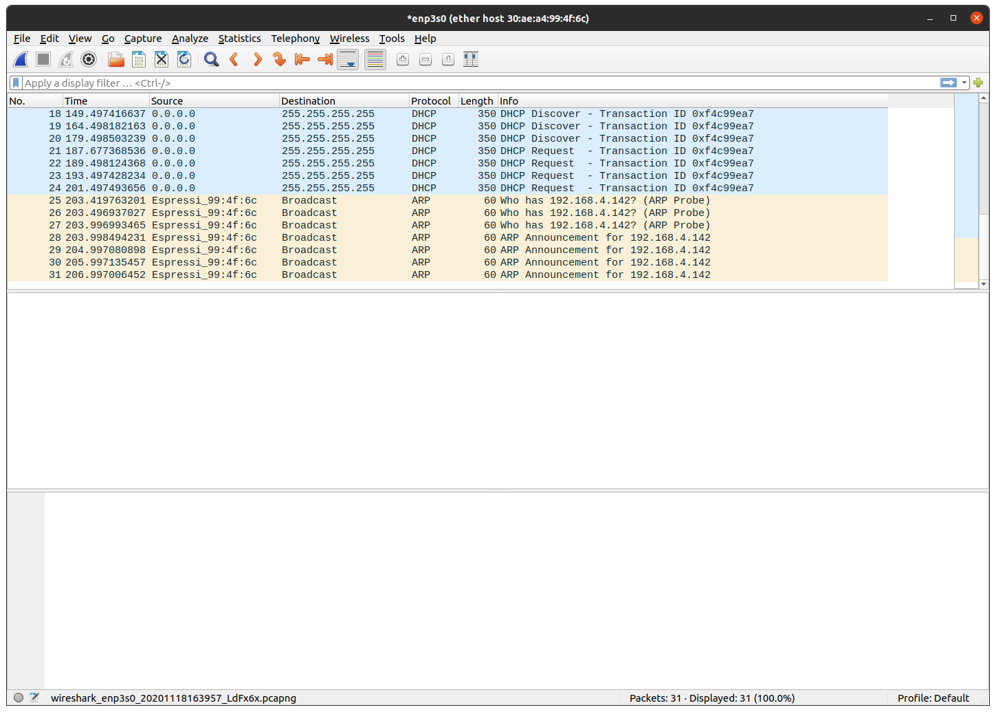

Notice, nothing other than DHCP and ARP traffic is making it on to the WLAN.
I played around with the esp_mqtt_client_config_t by directly specifying the host/port instead of the URL with the same results.
In the end, this does not appear to me as a MQTT issue but more of an LWIP or similar configuration issue. I have tried this with the defaults other than the example config settings so I'm hoping that someone has some things that I can test and hopefully get a successful network connection on my WLAN.
