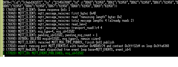

Hi, @markkuk yes normally i tried but loop wise upload to mqtt server is works fine. Problem this publish task not making to enter while (1) loop in app_main for esp32.
- Firmware stop at MQTT_EVENT Publish. Waiting to collect data for the next cycle from becon.
- 2021-06-11 post.png (13.36 KiB) Viewed 6500 times
- Posts: 15
- Joined: Tue Jun 01, 2021 10:21 am
Re: configure MQTT callback in non blocking mode for esp32 using esp-idf 4.2
I will be explaining again with my issue.
1. Created publish task to upload MQTT bluetooth data with every cycle. Here its results with two error i.e.,
a. when the function called uart_set_pin called (in uart_init function for UART 2 in esp32) this blocking cyclic publish for mqtt. If uart_set_pin is commented then cyclic publish works fine.
b. One more thing publish_task blocking while(1) in the main function (screenshot shared in my previous reply for the same post)(when the line commented as explained as mentioned as above).

printf("TOPIC=%.*s\r\n", event->topic_len, event->topic);
printf("DATA=%.*s\r\n", event->data_len, event->data);
break;
case MQTT_EVENT_ERROR:
ESP_LOGI(TAG, "MQTT_EVENT_ERROR");
break;
default:
ESP_LOGI(TAG, "Other event id:%d", event->event_id);
break;
return ESP_OK;
- Posts: 9046

@ ESP_Sprite Thank you for your response, actully using GPIO 17 & 16 for UART Tx and UART Rx respectively for ESP-WROOM-32 module. CTS and RTS disabled with -1.
- Posts: 15
Problem regarding Uart_set_pin resolved. But still, MQTT call back is blocking the main while loop(as shared screenshot previously) can anyone have a solution kindly let us know thank you in advance.
