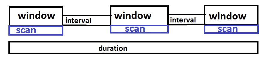

Postby newsettler_AI » Thu Jun 29, 2017 3:44 pm
Thanks for explanation!
Hope that I am interpreting this correctly
kolban
Posts: 1683
Location: Texas, USA
Re: Duration of BLE scan
Postby kolban » Thu Jun 29, 2017 5:22 pm
That's a great diagram. What isn't clear to me from my reading is the notion of "interval" and how it relates to "window". The docs say that window must always be <= interval. This makes me think that an interval might be "the size of window plus the size between windows".
So for example, if window is 100 msecs and interval is 200 msecs, then there will be a scan for 100 msecs and then idle for the next 100 msecs and then this repeats for duration period.
I think we may find that if we set window to be 100msecs and interval to also be 100msecs, it might be that a scan executes for 100 msecs and then we find that "interval" has elapsed and we repeat immediately ... for duration in total... effectively a constant scan.
