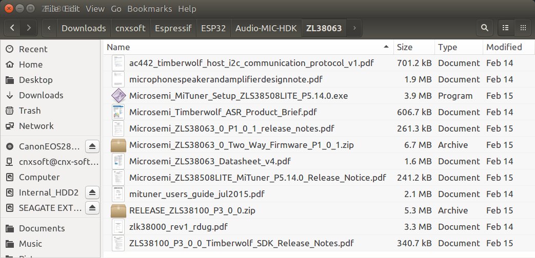

Postby rudi ;-) » Tue Feb 20, 2018 2:06 pm
Where are the Lyra demos?
ESP32-LyraTD-MSC Audio Mic HDK Demo with Baidu DuerOS
Microsemi ZL38063 Documentation & Tools
hope this helps in the meantime
wishes
fyi: sry i got this documents and tools not - microsemi did not response since 8 weeks :cry:
( i gived up this theme. final i will visit microsemi on eMbeddedWorld2018 too and ask them personaly for the "Why not"
also i will told them that i will not use they DSP in my future design cause they do not response to us developers
