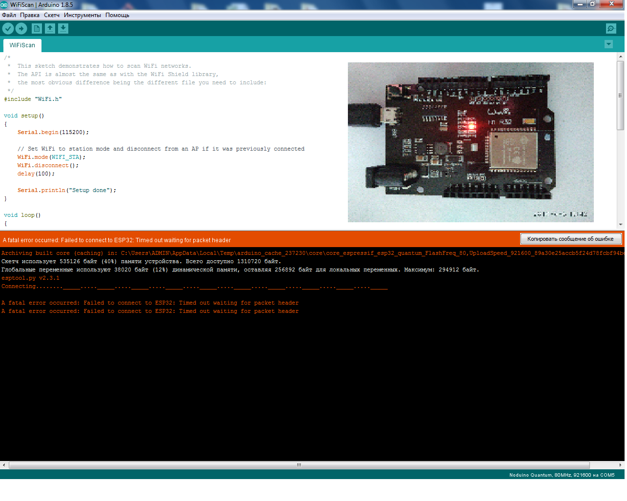

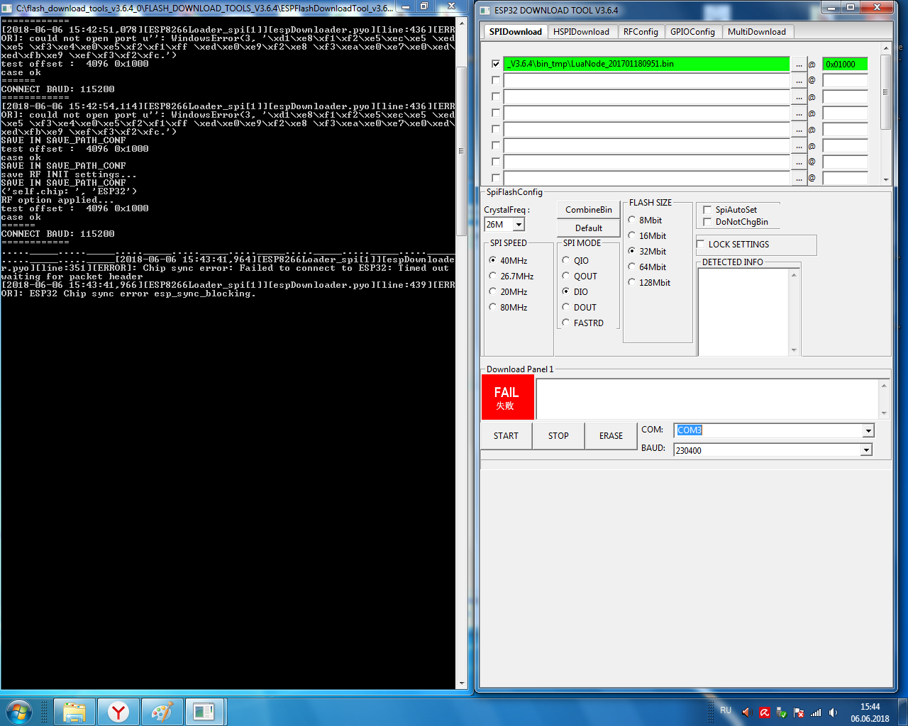

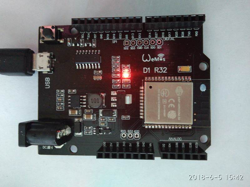

Hello, dear friends! I write to You from "wild" Russia-the bear also wants to keep up with advanced civilization)) Sorry for the inaccurate translation, but he does not speak English! Help, please, to solve a problem with my Board ESP 32 (wemos esp32 D1 R32) - does not start, does not sew. Screenshots of errors attached.
