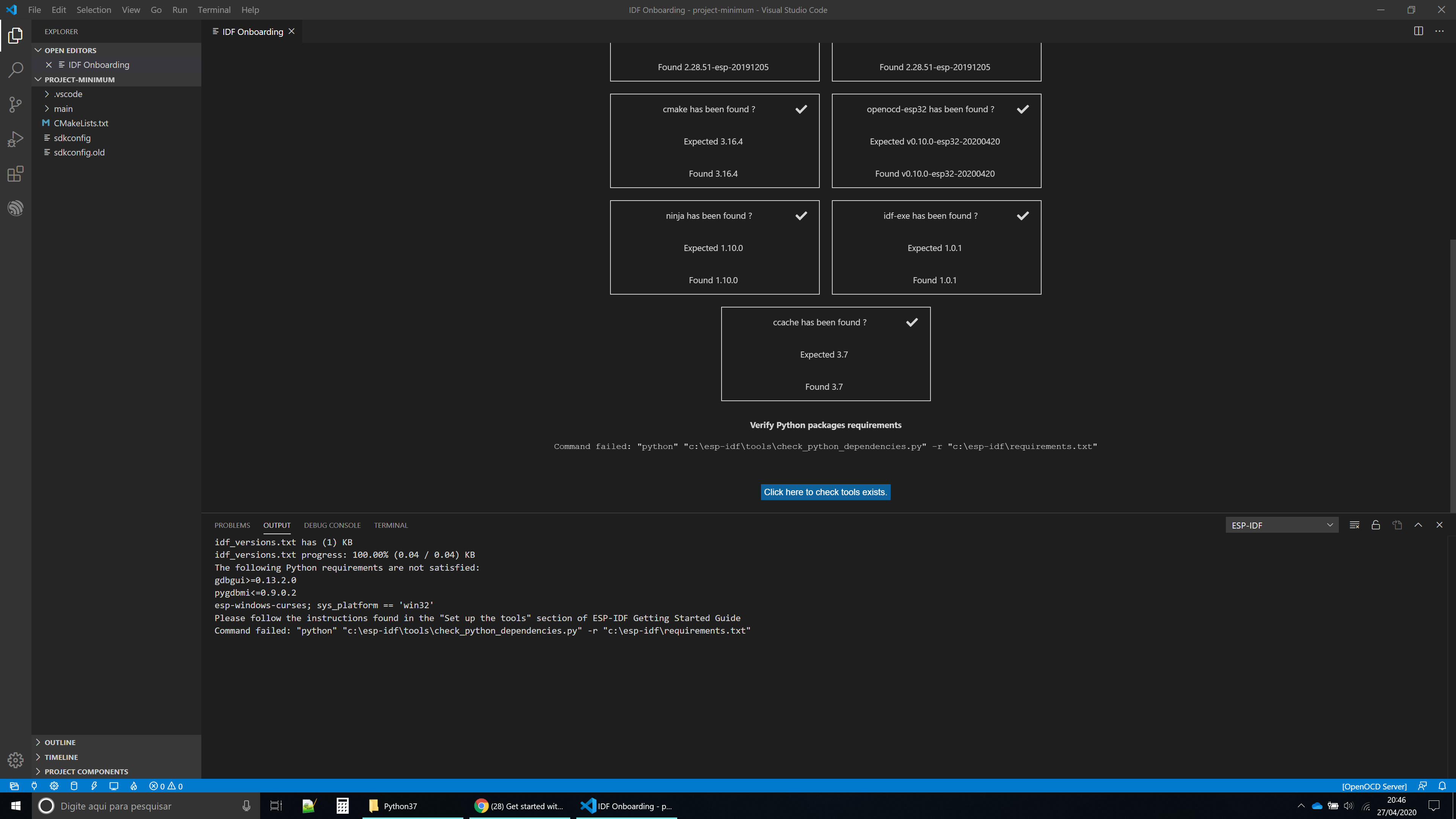

I am trying to install esp-idf on visual studio code using ESP-IDF Visual Studio Code Extension, but the error in figure in annex appears.
I had already configured the visual studio code manually with the esp-idf version "v4.1-dev-141-ga7e8d87d3" and it was working correctly.
But i decided to migrate to the new version of esp-idf "https://github.com/espressif/esp-idf", i don't know why i couldn't get the version with git describe.
I think "v4.2" something else.
I am using win10 pro version 10.0.17763 Compilation 17763.
Thank's for the help.

- vsc_install_err.png (376.59 KiB) Viewed 18910 times

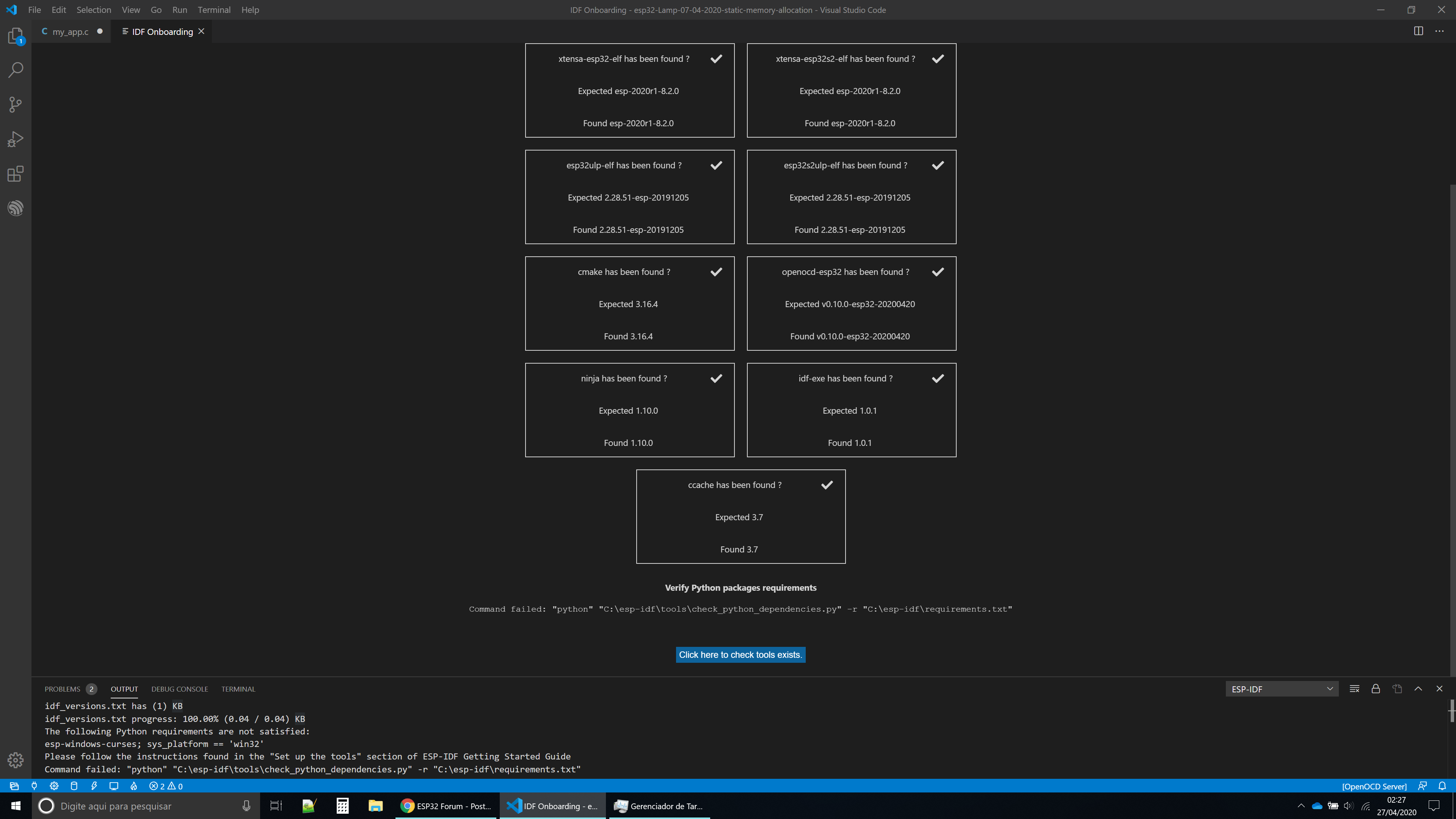

I decided to uninstall everything, including git and python and whatever was related.
I restarted the notebook just to make sure.
I downloaded the tools setup for windows: "https://dl.espressif.com/dl/esp-idf-tools-setup-2.3.exe".
And i let tools setup install all the necessary tools(everything, including esp-idf v4.2-dev-1235-g71dc5eb27, python, git and so on).
After this installation, the "ESP-IDF Command Prompt (cmd.exe)" opened.
I run "C:\esp-idf>git describe" and git returned me v4.2-dev-1235-g71dc5eb27.
I run idf.py menuconfig and run ok.
I configured project on menuconfig and all ok.
Afer save project config on menuconfig, i run idf.py buid and everything worked as expected.
So i decided to test it in visual studio code, using "Develop and debug applications for Espressif ESP32, ESP32-S2 chips with ESP-IDF" vsc plugin, and not worked.
In annex folows the image with the problem that i encountered.
I am waiting for a good soul to help me

- visual studio code error A.png (356.04 KiB) Viewed 18848 times

In windows cmd(administrator mode) i run: "python -m pip install --user -r %IDF_PATH%/requirements.txt".
After, i opened the project on vsc and started to config using espressif vsc plugin.
Other python "errors" appeared and a suggention to run: "python -m pip install -r c:\Users\myName\.vscode\extensions\espressif.esp-idf-extension-0.2.1\esp_debug_adapter\requirements.txt" appear.
I went back to the windows cmd and ran: "python -m pip install -r c:\Users\myName\.vscode\extensions\espressif.esp-idf-extension-0.2.1\esp_debug_adapter\requirements.txt".
After, i went back to the opened project on vsc and started to config using espressif vsc plugin again.
And worked(OK) message:
"Checking ESP-IDF Python requirements using python
Python requirements from c:\esp-idf\requirements.txt are satisfied."
"Checking Debug Adapter requirements using python
Python requirements from c:\Users\myName\.vscode\extensions\espressif.esp-idf-extension-0.2.1\esp_debug_adapter\requirements.txt are satisfied."
And appear a button written "Go to next step."
After clicked on button "Go to next step." the following message appeared:
"ESP-IDF Tools have been configured for this extension of Visual Studio Code".
