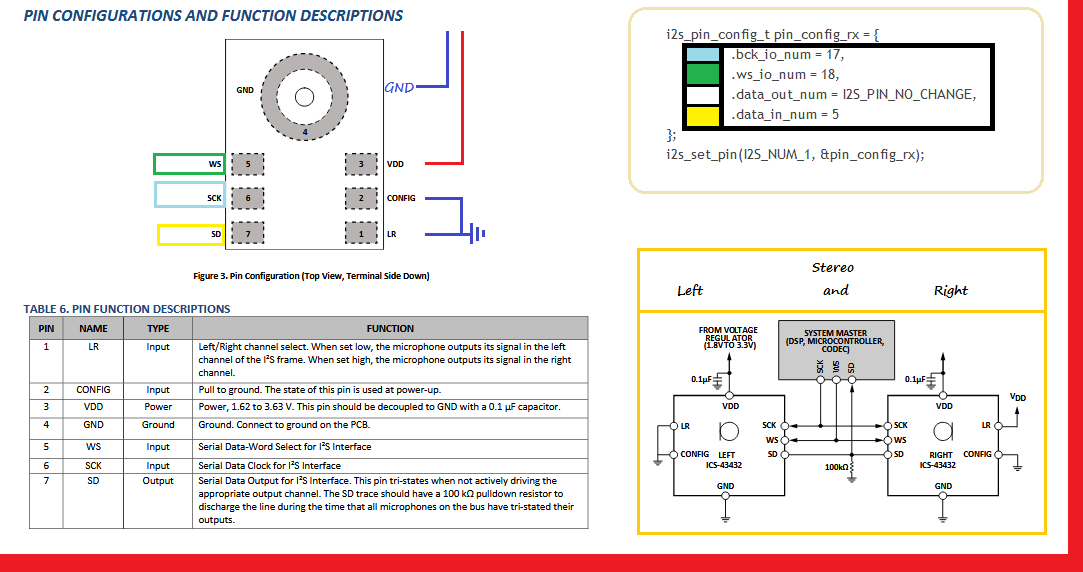

@Buddy
can't test - cause have just in time no I2S HW Mic on the Hand -
in this way you did - you use successful I2S0 ( I2S_NUM_0) for output and the I2S1 ( I2S_NUM_1) for input, right?
so this config must be valid for run for the ICS.I2S as Left Channel example?
and for Left and Right ( 2 Mics ) example too?
perhabs you can look small time on this picture, please:
what is your saying?
