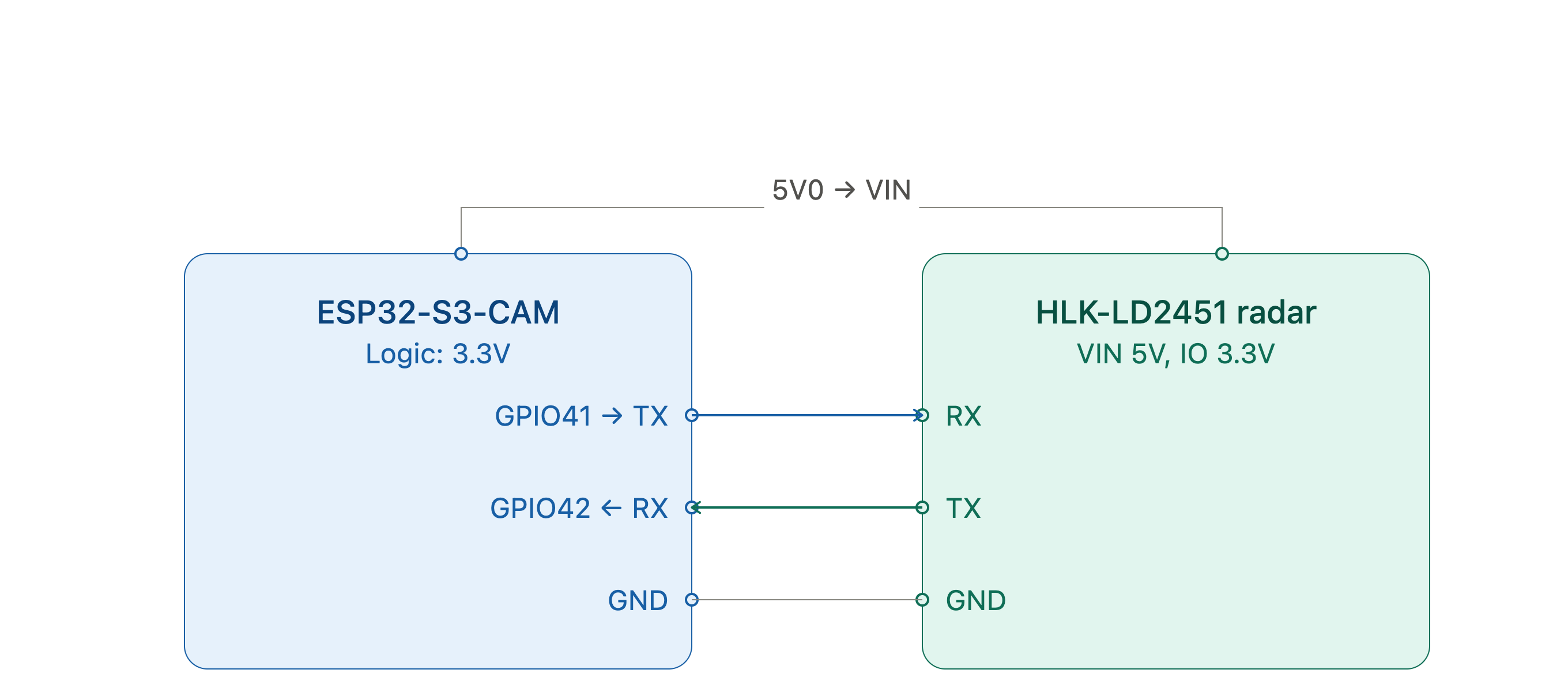

Board: ESP32-S3-CAM (GOOUUU N16R8, ESP32-S3-WROOM-1U-N16R8 module). Peripheral: HLK-LD2451 UART radar, 115200 8N1. Wiring: radar TX → ESP32 GPIO42 (RX), ESP32 GPIO41 (TX) → radar RX, shared GND, radar powered (confirmed 5.1V at its VCC pin with or without seperate power supply - power not issue, well within spec). enter image description here The problem: the ESP32 receives essentially nothing on GPIO42 — one single stray 0x00 byte near boot (doesn't match the protocol's real frame header, 0xF4), then complete silence for 130+ seconds, across every method tried.
What I've confirmed, in order:
1. Radar confirmed working via direct USB-serial connection to a PC — correct, continuous ~1Hz heartbeat frames (0xF4F3F2F1 header, correct tail, valid payload).
2. Continuity confirmed end-to-end, radar TX pin → GPIO42 header pin, with the full test setup wired and both listeners attached — no shorts to GND.
3. Voltage confirmed 5.1V at the radar's VCC.
4. A raw digitalRead() polling test (bypassing UART entirely, ~900k samples/sec for 10s) initially showed GPIO42 stuck flat LOW — turned out GPIO41/42 are part of the ESP32-S3's JTAG pin group (MTDI/MTMS), and the pin was apparently claimed by the USB-JTAG peripheral. Calling gpio_reset_pin() fixed this — pin now idles correctly HIGH and shows real transitions on the raw digitalRead test.
5. Despite that fix, the actual UART peripheral (tried via both Arduino HardwareSerial and raw ESP-IDF uart_driver_install/uart_param_config/uart_set_pin, all returning ESP_OK) still receives nothing.
6. Simultaneous check: tapped the radar's TX line to both the ESP32 and a USB-serial adapter → PC at the same physical node, same GND. PC reliably captures real frames. ESP32, on the identical wiring, still shows nothing but that one init byte.
What I'm ruling out: radar hardware, the wire/tap point (continuity confirmed on the exact live configuration), UART config/baud/framing (matches a validated Python reference implementation exactly), and JTAG pin claim (fixed, confirmed via raw pin toggling, didn't change the outcome). What's left, that I can't explain: the raw GPIO pad electrically toggles correctly, uart_set_pin() reports successful GPIO-matrix binding, and yet the UART peripheral itself never sees real traffic. What am I missing?

Postby Sprite » Wed Jul 15, 2026 12:14 am
Odd. I see no obvious issues in what you describe. Perhaps it's a connectivity issue - can you try a different GPIO or devboard?
