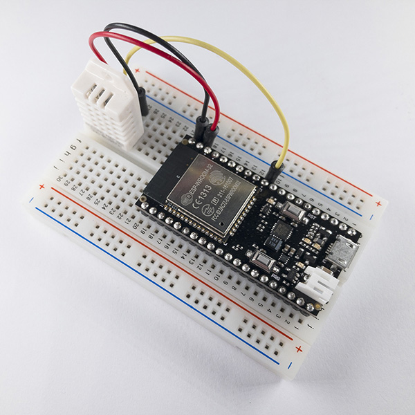

I'm using the Rocket 32-Rev1 (silicon rev. 0)
It's strange You need some mods on the sparkfun board.
They claim 2.5µA current in deep sleep for this board.

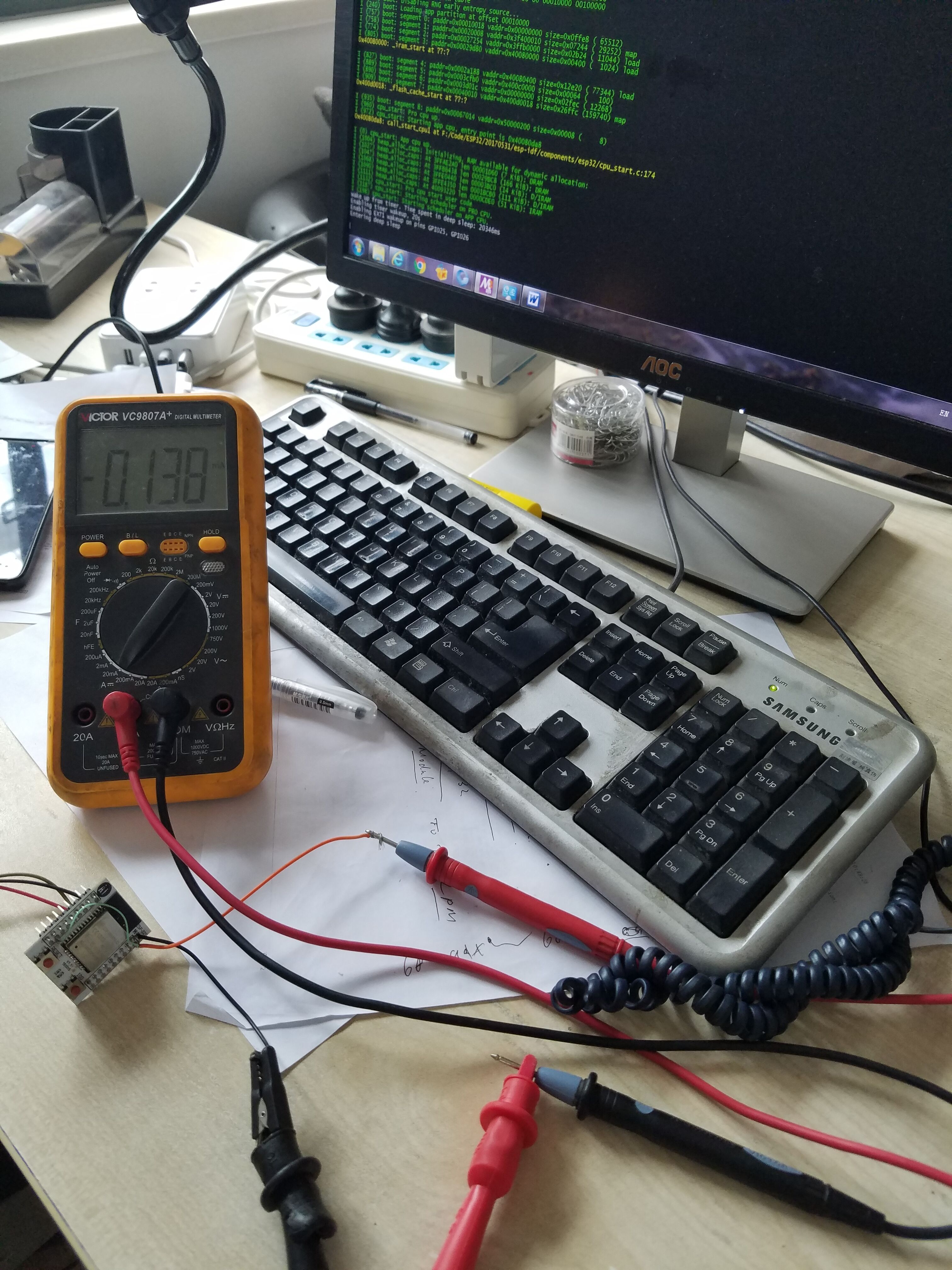

I tried the deepsleep example on esp_wroom_32 module.The current consumption in deep sleep was about 280uA@3.3V.And I tried to pulled up the /CS and modifid the code according to the above code, the current consumption reduced to 210uA@3.3A, which is much higher than the 20uA in the offical document.I want to know how to modify the code(or hardware?) to get the similar results in offical document.Thanx!

Could you please describe the connections you have to the module and measurement method? WROOM32 should not need any software mods to achieve 5uA deep sleep current.
Hi ESP_igrr,here is the the connections of the module and measurement method,now the current reduced to about 140uA@3.3V.Thanx!

temp4eb: Thanks for the photo... Could you please make a current measurement with CHIP_EN input pulled low?
