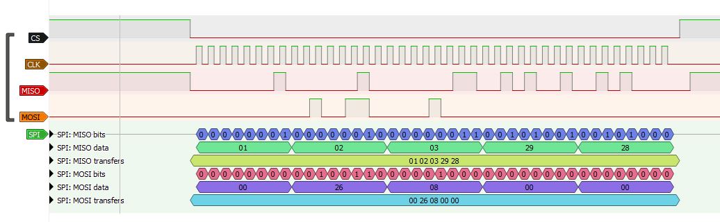

I am new to the forum but working with ESP32 chips for quite some time now, and I am running into the following issue.
For development of a product, I am integrating a W5500 SPI ethernet chipset with an ESP32-PICO-V3-02 in esp-idf v3.3.6
The driver (written using code extracted from esp-idf 4.4) is running reliably with SPI Master configured in Full-Duplex mode with DMA. However I would like to increase bus speed (currently 20MHz) and need to use Half-Duplex mode in order to raise bus speed to 40MHz, see details at the end of the post.
When trying to switch to Half-Duplex configuration with DMA, whatever the bus speed (I went down to 500KHz in order to capture transactions with a logic analyzer), some bytes get lost on multi-byte reads (single-byte reads seems to work fine). This problem happens at least on 2 bytes long reads, and not all the time. It is generally reading fine for a few transactions at startup before it starts to loose bytes (which reads as all zeros) on ALL following 2-bytes reads.
I am using SPI Master Address phase to send 24 bits header (Read address, bank etc.) followed by MISO phase only, as required by esp-idf driver, please see below.

  • I make all tests @ 500KHz, showing the exact same behavior that I get at 20MHz or 40MHz
  • I tried using a DMA-capable allocated buffer even for small (< 4 bytes) read operations instead of rx_data with no success
  • I tried forcing 4-bytes read transactions with no success (in this case all 3 last bytes reads 0 even if the device is sending non-zero data)
  • I tried with option SPI_DEVICE_NO_DUMMY which does not work better even at 500KHz. In this case it is sometimes the first byte that get lost instead of the second
Below is a capture from my logic analyzer:
And matching console output from the W5500_read function:
Code: Untitled.txt Select all
Read @ 002608 | len = 2 - RXDATA : 29 00 00 00
> ESP32 reads 29 00 instead of 29 28
Questions:

unfortunately, ESP-IDF version 3.3.6 is no longer supported. Please also check SPI documentation at https://docs.espressif.com/projects/esp ... own-issues if it helps you to resolve the issue.
