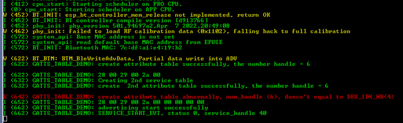

i want to add multiple service in the given BLE service table example. I tried to create another table and created attribute table manually, but before staring the 2nd service my device starts advertising and after connection I am not able to see the 2nd service that has been created.
BLE service table log
The event after creating first attribute table
        case ESP_GATTS_CREAT_ATTR_TAB_EVT:{
	        static bool SEC_service_Created = false;
	        if(0 == RB_service_handle[IDX_SVC])
		        if (param->add_attr_tab.status != ESP_GATT_OK) {
			        ESP_LOGE(GATTS_TABLE_TAG, "create attribute table failed, error code=0x%x", param->add_attr_tab.status);
		        else if (param->add_attr_tab.num_handle != RB_IDX_NB) {
				        "create attribute table abnormally, num_handle (%d) \
			                doesn't equal to RB_IDX_NB(%d)",
				        param->add_attr_tab.num_handle,
				        RB_IDX_NB);
		        else {
			        ESP_LOGI(GATTS_TABLE_TAG, "create attribute table successfully, the number handle = %d\n", param->add_attr_tab.num_handle);
			        memcpy(RB_service_handle, param->add_attr_tab.handles, sizeof(RB_service_handle));
			       //esp_err_t errz = esp_ble_gatts_start_service(RB_service_handle[IDX_SVC]);
			        esp_log_buffer_hex(GATTS_TABLE_TAG, RB_service_handle, RB_IDX_NB);
			       // if (errz != ESP_OK)
				   //     ESP_LOGE(GATTS_TABLE_TAG, " GATTS start service failure : %d", errz);
	        if (0 != RB_service_handle[IDX_SVC])
		        if (SEC_service_Created == false)
			        esp_err_t create_attr_ret = esp_ble_gatts_create_attr_tab(deivce_info_gatt_db, gatts_if, DEV_IDX_NB, SVC2_INST_ID);
			        ESP_LOGI(GATTS_TABLE_TAG, "Creating 2nd service table");
			        if (create_attr_ret)
				        ESP_LOGE(GATTS_TABLE_TAG, "create attr table failed, error code = %x", create_attr_ret);
			        else
				        SEC_service_Created = true;
				        ESP_LOGI(GATTS_TABLE_TAG, "create  2nd attribute table successfully, the number handle = %d\n", param->add_attr_tab.num_handle);
				        memcpy(RB_Dev_Service_handle, RB_service_handle, RB_IDX_NB);
				        memcpy(RB_Dev_Service_handle + RB_IDX_NB, param->add_attr_tab.handles, DEV_IDX_NB);
		        if (SEC_service_Created == true)
			        else if (param->add_attr_tab.num_handle !=  DEV_IDX_NB) {
					        "create attribute table abnormally, num_handle (%d), doesn't equal to DEV_IDX_NB(%d)",
					        DEV_IDX_NB);
			        else {
				        esp_err_t errz = esp_ble_gatts_start_service(RB_Dev_Service_handle[IDX_SVC]);
				        esp_log_buffer_hex(GATTS_TABLE_TAG, RB_Dev_Service_handle, RB_IDX_NB + DEV_IDX_NB);
				        if (errz != ESP_OK)
            break;
