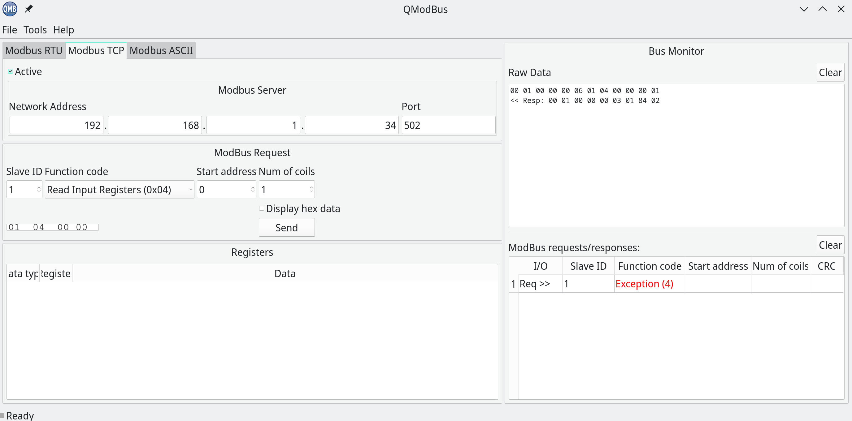

Hi, Im trying to setup Modbus TCP Slave on my esp32s3 using enc28j60 module.
Ive combined enc28j60 example with modbus slave tcp example.
Device gets address from dhcp without any problem.
When I want to read some data from device I do not get any response. Console clearly indicates that it recieved frame and accepted client communication but nothing else happends.

As you can see there seems to be no problem but after trying to communicate with device I do not get any response.
My console looks like this while trying to commuincate:

So it clearly recives frame but it doesn't do anything with it.
next data recieve attempt just drops the connection:
Code: Untitled.c Select all
E (163033) MB_TCP_SLAVE_PORT: Socket (#55)(192.168.1.12), connection closed by peer.
