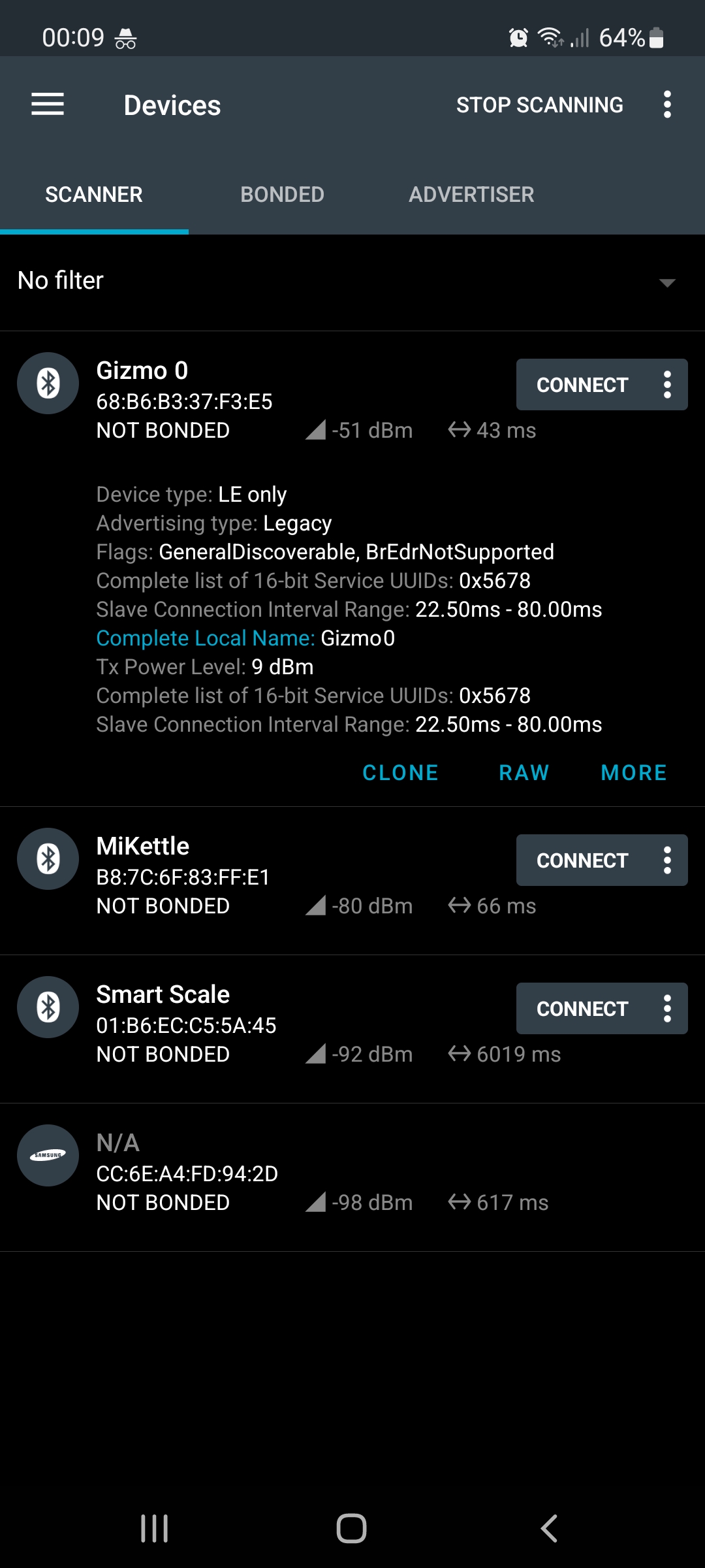

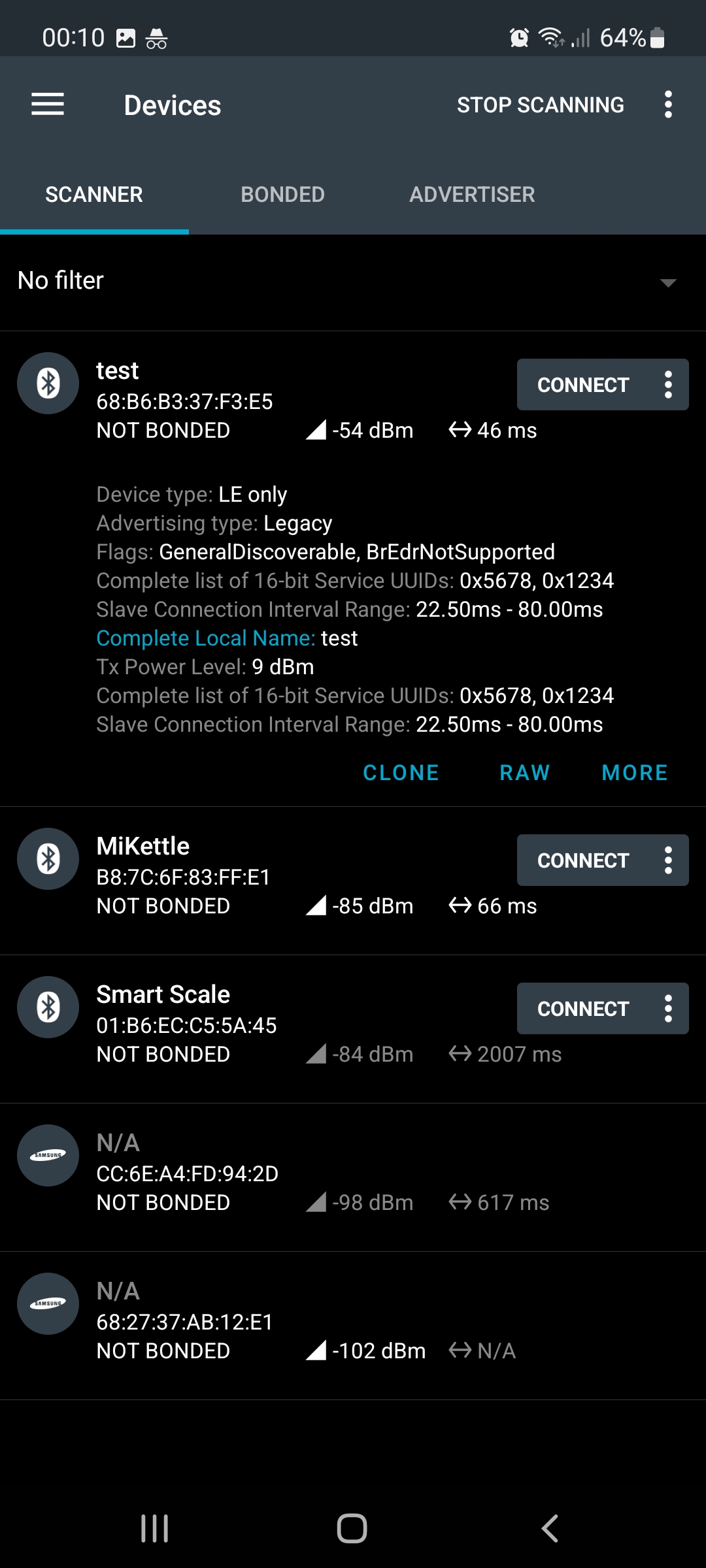

Like I said in previous post, it's easy:
- before
Screenshot_20220913-000958_nRF Connect.jpg (360.93 KiB) Viewed 5367 times
- after
Screenshot_20220913-001005_nRF Connect.jpg (394.2 KiB) Viewed 5367 times

           String test = "test";
           esp_err_t errRc = ::esp_ble_gap_set_device_name(test.c_str());
           if (errRc != ESP_OK) {
              log_e("esp_ble_gap_set_device_name: rc=%d", errRc);
           /* Update the BLE advertisement */
           BLEAdvertising *pAdvertising = BLEDevice::getAdvertising();
           pAdvertising->addServiceUUID("1234");
           pAdvertising->setScanResponse(true);
           pAdvertising->setMinPreferred(0x06);  // functions that help with iPhone connections issue
           pAdvertising->setMinPreferred(0x12);
           BLEDevice::startAdvertising();
           //delay(5);
           /* Advert has gone out, so re-initialise advert to null characters */
           for (j=8; j<=20; j++)
              advertText[j] = 0;
           j=8;  // We start collecting incoming data at the ninth character in the entire advertisement, eg: after "GadgetA1 "
           timeStamp = millis();
      else j++;   // Data is still coming in prior to advert going out.
   delay(10);
i tested it with S3, but should works with any esp32 with BLE.
PS all you have to do is to change code with the correct order; first change advertising value, then set it with esp_ble_gap_set_device_name and finally start advertising
