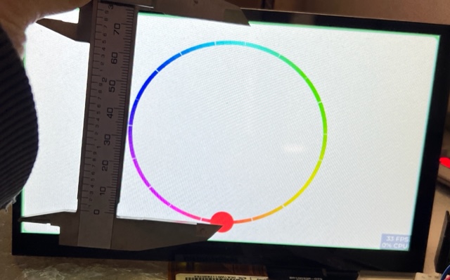

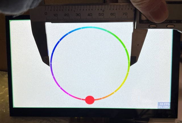

Its working well, Except that the image is slightly skewed.
All circles are egg-shaped when they should be perfectly round.
Its difficult to show, but here are some images.
Perhaps it has something to do with the LCD timings? I tried changing them in many ways to no avail.

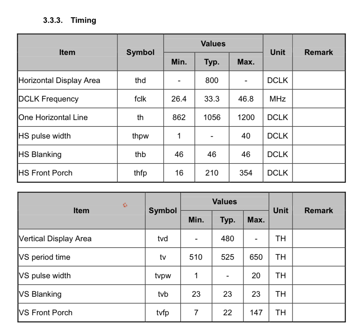

Currently my LCD is created with these timings:
  esp_lcd_rgb_panel_config_t panel_config = {
        .data_width = 16, // RGB565 in parallel mode, thus 16bit in width
        .bits_per_pixel = 16,
        .psram_trans_align = 64,
        .clk_src = LCD_CLK_SRC_DEFAULT,
        .disp_gpio_num = EXAMPLE_PIN_NUM_DISP_EN,
        .pclk_gpio_num = EXAMPLE_PIN_NUM_PCLK,
        .vsync_gpio_num = EXAMPLE_PIN_NUM_VSYNC,
        .hsync_gpio_num = EXAMPLE_PIN_NUM_HSYNC,
        .de_gpio_num = EXAMPLE_PIN_NUM_DE,
        .data_gpio_nums = {
            EXAMPLE_PIN_NUM_DATA0,
            EXAMPLE_PIN_NUM_DATA15,
        .timings = {
            .pclk_hz = EXAMPLE_LCD_PIXEL_CLOCK_HZ, //(18 * 1000 * 1000)
            .h_res = EXAMPLE_LCD_H_RES, //800
            .v_res = EXAMPLE_LCD_V_RES, //480
            // The following parameters should refer to LCD spec
            .hsync_back_porch = 46,
            .hsync_front_porch = 210,
            .hsync_pulse_width = 1,
            .vsync_back_porch = 23,
            .vsync_front_porch = 147,
            .vsync_pulse_width = 1,
            .flags.pclk_active_neg = true,
        .flags.fb_in_psram = true, // allocate frame buffer in PSRAM

Are you sure the pixels on the display itself are square? (As in, can you link the datasheet, or calculate the H and W of a pixel yourself?)
vritzka
Posts: 33
Joined: Wed Sep 07, 2022 5:33 am
Re: Why is the image on my LCD skewed?
Postby vritzka » Sat Sep 17, 2022 3:38 am
the Dot Pitch is 0.0642 (w) x 0.1790(h) mm
So the pixels are not square if I understand correctly.
I also attached the Datasheet. If you have a moment, would you please have a look?
