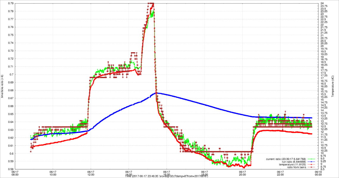

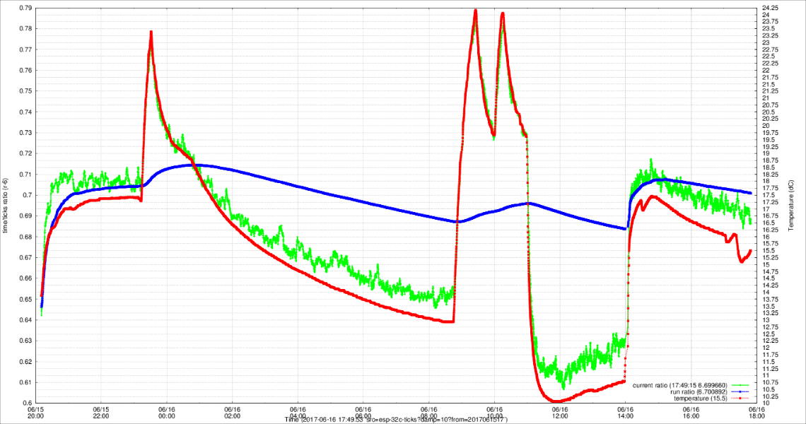

I was looking at it. I am now evaluating it. It has a very tight relationship to temperature. I have a ds18b20 on the board adjacent the module and this is what I see:
The red line (right scale) is the temperature and the green (left scale) is the ratio of tick count to wall time during the last app cycle (about 6 seconds). The left scale is the deviation of the ratio from a value of 6.0, so a ratio of 6.69 is plotted as 0.69. This line is dampened by a sliding average of 10 readings.
The blue line is the average ratio for the whole run, so a ratio of 6.7 can be used in the absence of temperature reading. The ratio varies slightly from module to module.

Very nice graph! 6.7 us / tick seems to be fairly close to the nominal period of RTC_SLOW_CLK (1 / 150kHz).

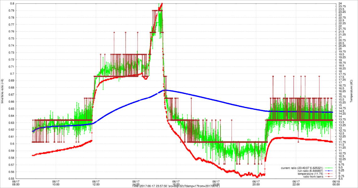

Here is a first stab, using a linear function based on measurements at 10dC and 25dC.
The brown line is the calculated time/ticks ratio. As before, the green is the measured ratio and the red is the ds18s20 temperature.
The plots are dampened (8 point average), the actual data is much more jittery
Looks like TSENS has a resolution of 2dC.
