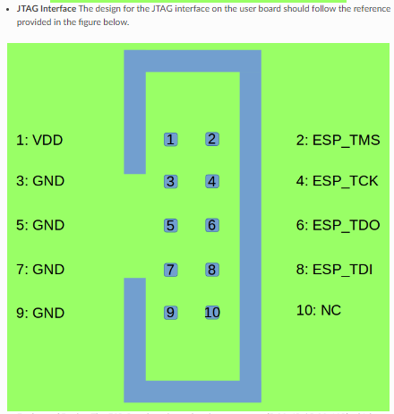

I have connected the header on the ESP-PROG, as per the documentation and rechecked it many times
Prog_Header
ESP-PROG Header 2022-10-26 172034.png (85.9 KiB) Viewed 4510 times

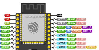

On the ESP32 S3 side, I connected to 3V3, GND and the JTAG pins (in light blue) as in the image below.
ESP32-S3-Pins
ESP32-S3-WROOM-1 2022-10-26 172333.png (77.01 KiB) Viewed 4510 times

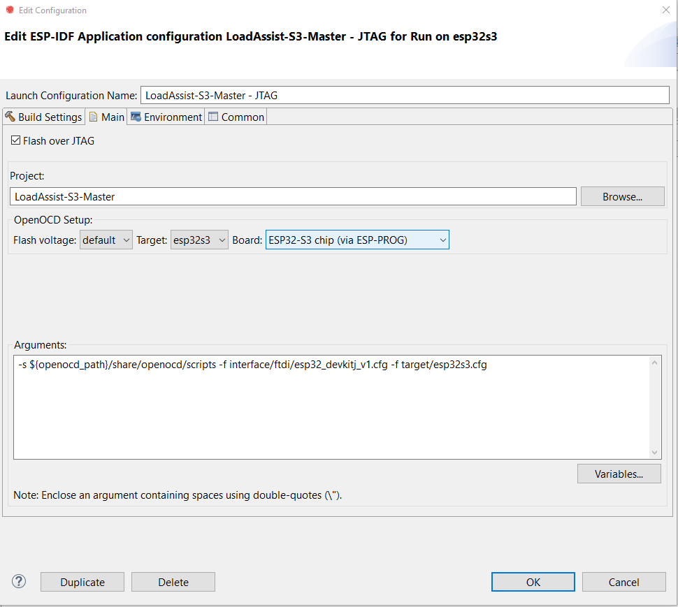

The launch config has been setup as follows:
Launch Config
LaunchConfig 2022-10-26 172739.png (38.11 KiB) Viewed 4510 times
The console output is as follows if I just press the RUN button with the selected config in Espressif IDE.
Open On-Chip Debugger  v0.11.0-esp32-20220706 (2022-07-06-15:48)
Licensed under GNU GPL v2
For bug reports, read
adapter speed: 10000 kHz
Flashing C:/ESP32/Projects/LoadAssist-S3-Master/build/bootloader/bootloader.bin at 0x0
Info : ftdi: if you experience problems at higher adapter clocks, try the command "ftdi tdo_sample_edge falling"
Info : clock speed 10000 kHz
Error: JTAG scan chain interrogation failed: all zeroes
Error: esp32s3.cpu0: IR capture error; saw 0x00 not 0x01
Error: Unexpected OCD_ID = 00000000
Warn : target esp32s3.cpu0 examination failed
Warn : target esp32s3.cpu1 examination failed
Info : starting gdb server for esp32s3.cpu0 on 3333
Info : [esp32s3.cpu0] requesting target halt and executing a soft reset
Error: Target not examined yet
Info : [esp32s3.cpu1] requesting target halt and executing a soft reset
** Flashing Failed **
-1

Also note from the console output, that I have reduced the speed to 10MHz

As per default configuration, ESP32S3 comes with NOT being able to use the JTAG pins.
You need to set a efuse in order to enable JTAG pins 39 to 42.
See here
https://docs.espressif.com/projects/esp ... -jtag.html
