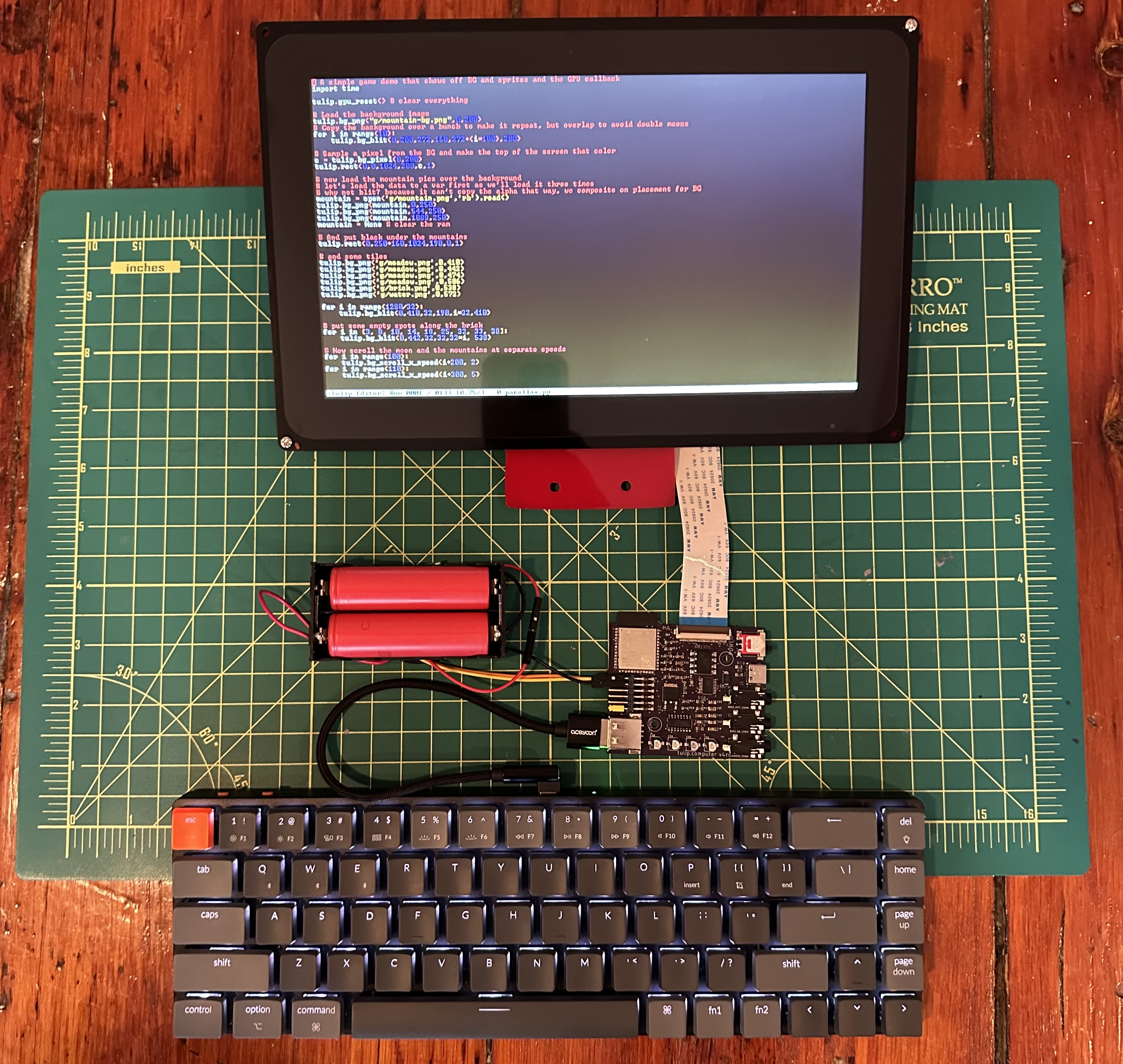

Just a FYI, thanks for the help on the bounce buffers. I'm able to get a stable 30FPS at RGB332 on a 1024x600 RGB dot clock display. It's all to service a little computer running on just a ESP32-S3 running Micropython, with support for "hardware" sprites and scrolling. All the code and hardware specs are here:
https://github.com/bwhitman/tulipcc
