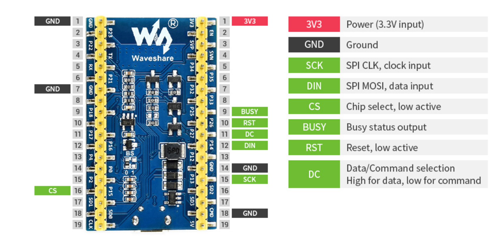

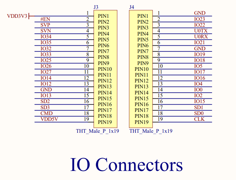

I am attempting to use this waveshare custom ESP32 board with an SD card reader. I want to display the the images on the SD card to the waveshare EPD. The problem is, I continually get this error when connecting the SD voltage:
rst:0x7 (TG0WDT_SYS_RESET),boot:0x13 (SPI_FAST_FLASH_BOOT)
configsip: 0, SPIWP:0xee
mode:DIO, clock div:1
load:0x3fff0030,len:1344
load:0x40078000,len:13864
load:0x40080400,len:3608
entry 0x400805f0
I have tried using an external source for the 5v input to the SD card reader but I get the same result. I have also tried using different GPIOs but to no avail. Any ideas? THANK YOU!!
Pinout attached.

Hey ole_sticky_keys,
did you solve the problem? I am currently at the same point.

Postby bidrohini » Fri Apr 14, 2023 1:15 pm
Here is a thread about the TG0WDT_SYS_RESET error.
viewtopic.php?t=3267
