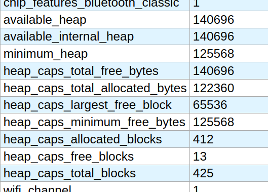

I'd look for either a leak or memory fragmentation that prevents a large-enough block from being allocated. I used heap_caps_get_info to make a detailed report about memory issues. If the minimum heap is dropping below 50K or so, that might be an issue for the next allocation.

Thank you for the reply. I can check using `heap_caps_get_info`, but this application did not have a memory leak with v4.4.2 of the ESP-IDF, and going to v5.0 I didn't change the application. I have been running `heap_caps_get_free_size(MALLOC_CAP_8BIT)` and that's holding steady around 160k. I don't think my problem is a memory leak. I recall several months ago I had an issue with v4.4.x holding on to socket handles even after they were closed and I'd run out of them quickly. That problem was solved by setting an option or a patch somewhere (I don't recall what it was).
This case is a bit weird. I don't see any other evidence of an issue other than the ability to open any kind of Ethernet connection to/from the ESP32 is suddenly denied.
EDIT: I just checked minimum free heap and it's holding steady at 130k. If I can't make much headway on this, I'll just remove v5.0 and revert back to v4.4.2 and wait for v5.0 to mature a bit further.
