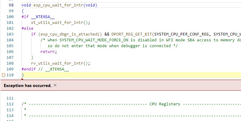

I've been having a painful time getting debugging to work on the ESP32S3. I have a Espressif sample I2C application that runs fine when programmed over the serial port. Connect via JTAG using the ESP-Prog, I've jumped through various issues such as
1) "connect ECONNREFUSED 127.0.0.1:9998"
Solved in launch.json, changing mode to auto seems to solve this (no idea why because the Espressif sample code is "version": "0.2.0" and specified it as "manual"
2) Then I get "Failed to init Debug Adapter!" when trying to run with debugger. Looking at the OUTPUT window it shows "ERROR - Failed to wait for completion of command". So I find a resource telling me in launch.json, change tmoScaleFactor from 1 to 2 which I do.
Now when I run the debugger, I never get to my application, instead I get "Exception has occurred" errors occurring in the SDK code (e.g. cpu.c after esp_cpu_wait_for_intr()
Is there anyone who can help me solve this and just get the ESP32S3 up and running for JTAG debugging?
The Halt exception screen grab is attached.
I'm using VSCode for Windows, I've used the VSCode Espressif IDF plugin to perform my install.
Here's my launch.json

Here's my OUTPUT window with an "Exception has occurred" halt
[Debug Adapter]
DEBUG_ADAPTER_STARTED
2023-01-31 15:07:53,838 - Debug Adapter (main) - CRITICAL - Debug adapter -> Extension: DEBUG_ADAPTER_STARTED
[Debug Adapter]
DEBUG_ADAPTER_READY2CONNECT
2023-01-31 15:07:53,842 - Debug Adapter (main) - CRITICAL - Debug adapter -> Extension: DEBUG_ADAPTER_READY2CONNECT
[OpenOCD]
[OpenOCD]
Info : New GDB Connection: 1, Target esp32s3.cpu0, state: halted
[Debug Adapter]
2023-01-31 15:08:01,352 - Debug Adapter (main) - WARNING - The operation took too long! - Measured 7.507739 s ( from ~ 15:07:53,844678)
[OpenOCD]
Info : dropped 'gdb' connection
[OpenOCD]
[OpenOCD]

Postby bignacio » Wed Feb 01, 2023 3:23 am
Could you share the extension troubleshooting information ?

Postby skanky » Wed Feb 01, 2023 8:31 am
Thank you for the response
Log attached

skanky
Posts: 20
Joined: Mon Nov 21, 2022 12:58 pm
Re: ESP-Prog JTAG debugging with ESP32S3
Postby skanky » Thu Feb 02, 2023 6:50 am
Hi support, can you please respond to this? I am in the United Kingdom and need this issue with your debugger tool resolved urgently please

It seems something went wrong after switching threads in your application. In your .vscode/launch.json could you change your logLevel to 4 to increase the output from debug adapter. This should give us a bit more detail about the error.
You could also play with the tmoScaleFactor to increase the waiting time from the debug adapter, maybe it helps.

bignacio
Posts: 255
Joined: Wed May 02, 2018 12:12 pm
Postby bignacio » Fri Feb 03, 2023 8:29 am
I see the issue now.
You have defined
"initGdbCommands": [
            "target remote :3333",
            "symbol-file /build/VimmsLite_main.elf",
            "mon reset halt",
            "flushregs",
            "thb app_main",
            "c"
and as specified in the debugging documentation but initGdbCommands doesn't need to be defined by default. The error in the log is because /build/VimmsLite_main.elf cannot be found by gdb

Posts: 20
Postby skanky » Fri Feb 03, 2023 9:04 am
Hi thank you, I have tried deleting the initGdbCommands block and it now works so that is great thank you :-)
