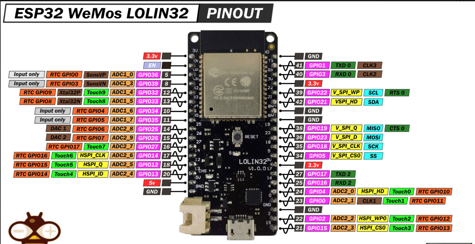

I need some assistance with connecting a Lolin ESP32 to a 7 pin SPI Oled display.
I am currently using the code and pin outs laid out in the code below but I just cannot get anything to display. VCC is connected to a 3.3V pin and not the 5v pin

I used the below pin out diagram to get the correct GPIO pins to reference in the code
Any help would be greatly appreciated as I have been struggling for hours with no progression.

You should use SPI pins, which is on 18 19 23 pins. (On the right side, in light blue background)
