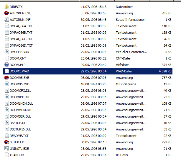

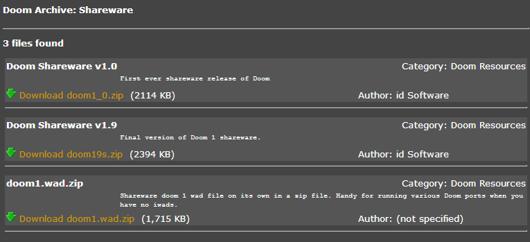

chocolate doom ESP32 port?
Not sure but i think the needed wad from here can be used?
this is 93/95 public version ( PR version )
not sure which is the right :
FYI: ( german )
doom1.wad public in this PR download version
or this ( doomarchive.com ) shareware hope this helps.
rudi
