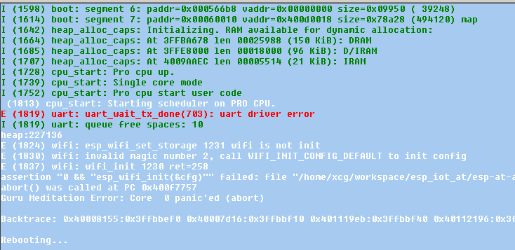

I think that the problem is the version of the esp-idf and esp-at-master example. the monitor console shows me:
E (1826) wifi: esp_wifi_set_storage 1230 wifi is not init
W (1832) wifi: wifi nvs_open fail ret=4353
E (1835) wifi: wifi_init 1191 ret=4353
assertion "0 && "esp_wifi_init(&cfg)"" failed: file "/home/xcg/workspace/esp_iot_at/esp-at-application/components/esp-at-core/./at_port.c", line 560, function: initialise_wifi
abort() was called at PC 0x400f732f
Guru Meditation Error: Core 0 panic'ed (abort)
And from what i could read in https://github.com/espressif/esp32-at/issues/6 and https://github.com/espressif/esp-idf/co ... a27e5bbdc7, a update may cause the problem. That's right?

I have same issue, before update esp-idf
espressif/esp32-at works perfecly
Today i have update esp-idf (10.03.2017)
Nothing help, (BT is on, flash erase done).
any ideas ?
sorry for my poor english

i get the same rebooting guru :)
if i use BT in the menuconfig it helps not again ( this have done the job erase )
must look deeper
this make me thinking:
/c/at_2036/esp32-at/sdkconfig:85:warning: symbol value '' invalid for PHY_DATA_OFFSET
update:
E (1825) wifi: esp_wifi_set_storage 1231 wifi is not init<\r><\n>
E (1831) wifi: invalid magic number 2, call WIFI_INIT_CONFIG_DEFAULT to init config<\r><\n>
E (1838) wifi: wifi_init 1230 ret=258<\r><\n>
assertion "0 && "esp_wifi_init(&cfg)"" failed: file "/home/xcg/workspace/esp_iot_at/esp-at-application/components/esp-at-core/./at_port.c", line 560, function: initialise_wifi<\r><\n>
abort() was called at PC 0x400f7757<\r><\n>
Guru Meditation Error: Core 0 panic'ed (abort)<\r><\n>
update:
cause the file:
is on the espressif developer pc, and AT is in the lib, we can not patch it.
we must wait for the support/patch from espressif developer "xcg"
perhabs it will be better, AT Lib goes open!
this closed things to libs is not good in open source and for debug!
you have to go back to the preview version of IDF SDK <7eaf1c76dc281c37075f8a8dac34cc3e09669f59> which it runs
sry for this
ps
espressif will fix asap

i ran into the Guru meditation error too after upgrading from ESP-IDF 2.0rc1 to 2.0release.
the issue was a bug in the single-core mode. your issue looks the same.
See https://github.com/espressif/esp-idf/issues/496
