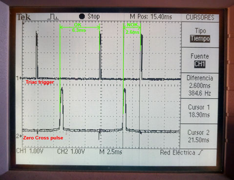

Hi to all!
Im looking for any tip as im getting crazy.
Im trying to create a stable AC phase control, and to do it I use a interrupt on rising linked with the zero cross detection, and set up a timer, to delay the triac gate activation. Then, change the timer delay to maintain the high pulse for certain minimum time.
It works, but ocassionally it fails, and the light flicker, becasue the triac is triggered earlier that it should be.
Attached an image where I catched the fail. The right timer delay is 6300uS, the delay for the high state of the trigger pin to the triac is 200uS. The same behaviour with different timer loads.
Code is this. It include another hardware timer, to generate a interrupt each second. The problem persist even if I deactivate this "each second" interruption:

Any tip will be welcome.
Thanks in advance.

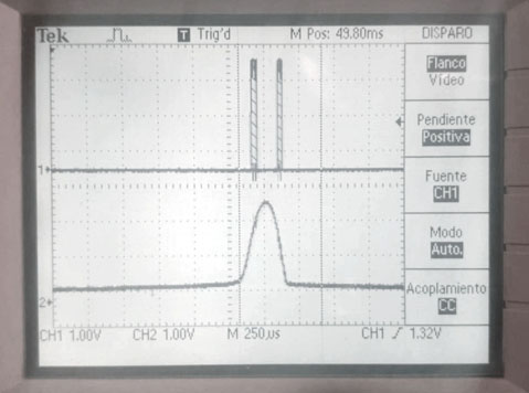

Hi there!
Well.. seems to be solved after many hours. A brief explanation. Next picture shows a pulse on external interrupt on pin, that was defined like:
attachInterrupt(digitalPinToInterrupt(Pin_BACS), int_BACS, RISING);
So, it detects it twice... Not sure if this can be justified by an undefined pin state/noise, or its becasue the RISING property is not correctly defined and instead CHANGE is compiled.
In any case, what I was not aware about the interruption stack, that it keeps this second (undesired) interruption to be attended later, (even if the interrupt was detached previusly) when the interruption is attached to the pin again.
So, as this "old" interruption is handeled once I attached the ISR again to the pin, it triggers inmediatly the timer interruption
Im not sure what is more correct, if clear the flag of the interruption or just use
gpio_intr_disable(GPIO_NUM_33);
as I have used right now.
Any advice/comment?

In my case I built my zero crossing detector, it happened to me that there were rising edges that were not detected or that the interrupt was executed during the falling edge.
It worked for me to make a debounce routine in the interrupt routine so that this code is not executed twice in a row.
im just did a toogle rutine in GP_2_pin when zero cross is detected to see it in the osciloscope.
