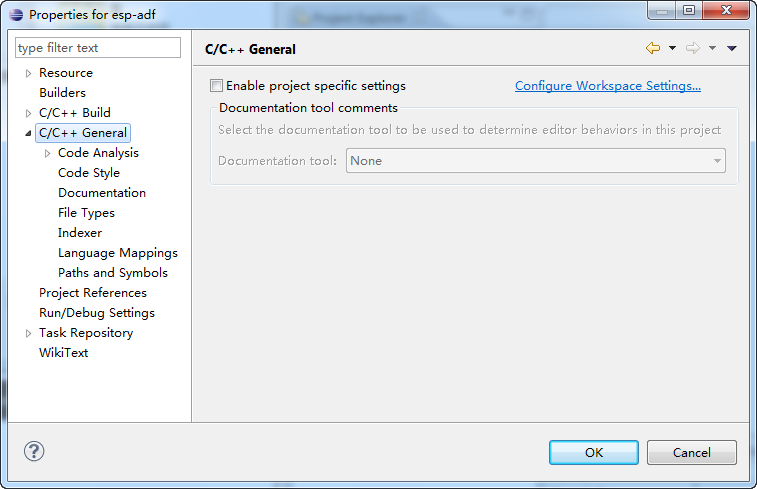

Hi
as the Build and Flash with Eclipse IDE guide shows
Navigate to “C/C++ General” -> “Preprocessor Include Paths” property page:
but there is not any item about “Preprocessor Include Paths” in my eclipse IDE, does any body knows why?

Re: where is the "Preprocessor Include Paths" in my eclipse IDE ?
that is caused by the version of eclipse , the lastest one could be OK
my version of eclipse is
Version: Indigo Service Release 2
Build id: 20120216-1857
it does have this item. it needs to update the lastest one

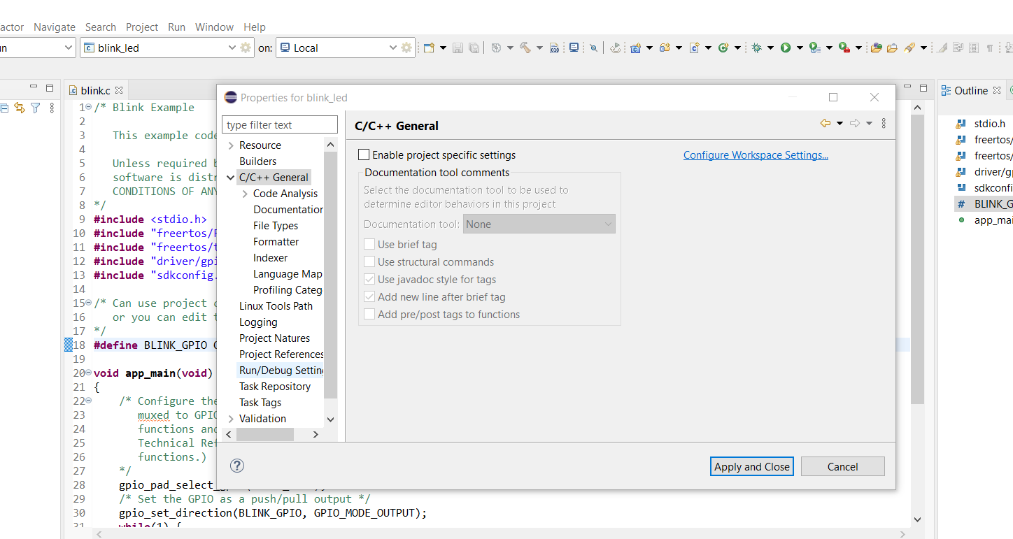

I have the exact same issue.
I am using Eclipse IDE:
Version: 2020-12 (4.18.0)
Build id: 20201210-1552
and the Preprocessor Include paths menu item is no where to be found.
Attached is a screen shot of my menu.
Can anyone help?

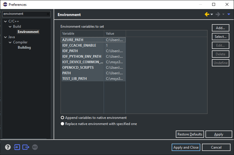

Mine is all latest with V4.3 beta-1. It's under C/C++->Build->Environment.

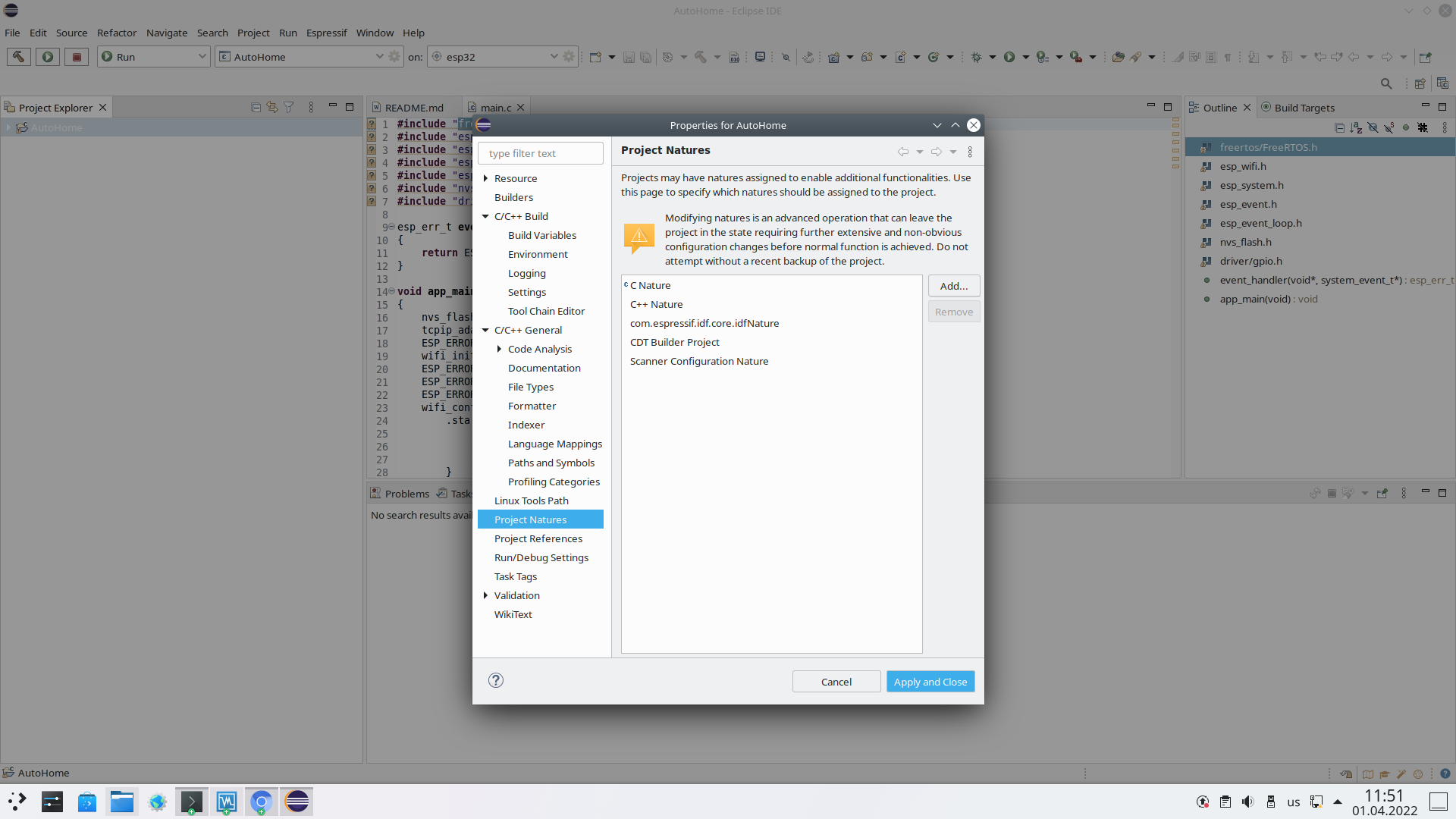

Hi, same now with latest Eclipse
Eclipse IDE for C/C++ Developers (includes Incubating components)
Version: 2022-03 (4.23.0)
Build id: 20220310-1457
tried:
Go to project properties (right button on project -> Properties OR menu-File-Properties)
Go to "Project Natures"
Add
"CDT Builder project"
confirm all questions
press "Apply and close"
also i added "Scanner configuration nature" because both of them exists in C++ type projects.
in result path option added but errors occurred
still trying
upd. stopped tries. because after building projects all paths added automatically to folder and all included files are shown without errors. No need any additional natures or whatever else. Just make first build.
upd. Now searching how to add another folder to "include"-path (arduino-esp)
upd. Finaly i got it
