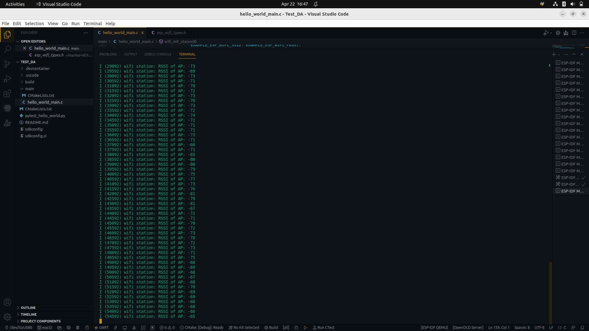

Hello Everyone
I was trying to check the signal strength of my wifi configured in an ESP32 WROOM DA module using its special dual antenna. But, although configuring each antenna as rx and tx I didn't find any major difference between the RSSI value of the DA module and normal esp 32 modules.
I just wanted to know if I was configuring the antenna correctly. Below is my attached code for setting the controller into STA mode.

Below are the values of rssi I am getting from both modules. I don't see much of a difference here and I feel like the DA module should perform much better than this
Please let me know If I am doing something wrong in my code.
Values from normal ESP 32
Screenshot from 2023-04-22 16-47-13.png (305.6 KiB) Viewed 1735 times
RSSI Values of DA

Hello @ ESP_alisitsyn can you help me in identifying the problem above? I am trying to configure the DUAL antenna in the DA module in AUTO mode.
