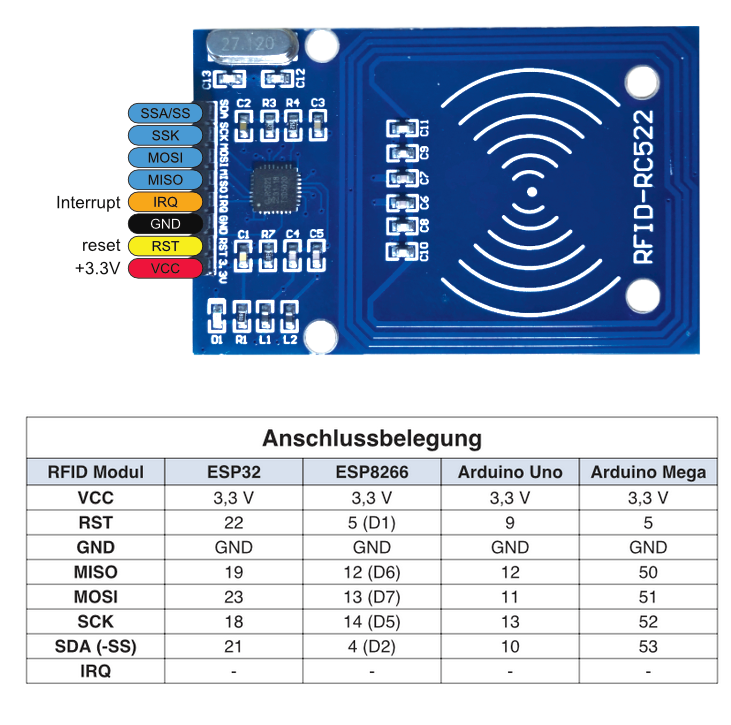

I'm new in the ESP32 field, have only experience with arduino. I am wondering if there might be some general thing I missunderstood in working with ESP 32. I used this code example of the MFRC522 library called DumpInfo... I watched several Videos where it worked perfectly, also used the same wiring shematics.( attached) I was wondering because some people used either Pin 5 or 21 for the SS but either way it worked. I also checked wiring connections, I checked everything on the hardware side so it must work, but it doesen't.
I then tryed to connect it with arduino and it worked. So the hardware is good. I'm lost, I tryed everything and have no Idea what it could be... might be a SPI relatet Issue or so but idk. I have a ESP32 wroom with two cores, don't know if that is releveant or not.
I hope anyone can help me
Screenshot 2022-04-05 164345.png (409.24 KiB) Viewed 11212 times

The numbers listed on the drawing are ok, but are not the default. You can supply numbers to SPI when you call begin (https://github.com/espressif/arduino-es ... /SPI.h#L63)
SPI.begin(18, 19, 23, 21); //SCK, MISO, MOSI, SS
