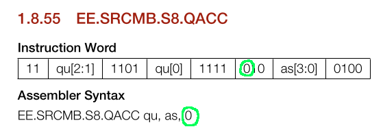

On the subject of the EE.SRCMB.S[8/16].QACC instruction, there appears to be an undocumented sel2 field in the instruction. It is shown in the assembler syntax provided for this instruction in the technical reference manual :
Screenshot from 2023-05-17 18-48-39.png (27.31 KiB) Viewed 973 times
I verified that it is possible to substitute the 0 at the end (circled in green in the screenshot) with a 1 and that this changes the result stored in qu in some circumstances, but I've been unable to determine exactly how. Is there any explanation for the presence of this bit or its effect?
