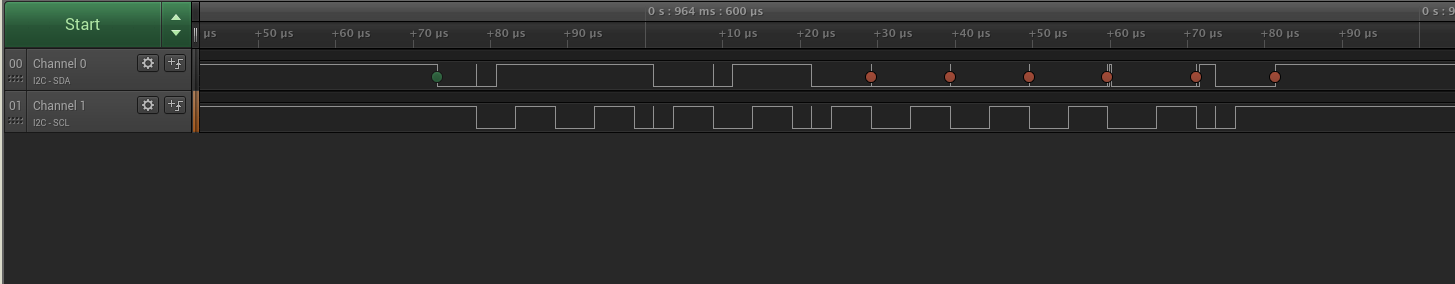

Hi, During debugging code interacting with DS3231 over I2C I noticed that my Saleae analyzer cannot decode I2C signals.
I've minimized example to the following (just send address) to make sure analyzer works:

It output success like:
address=0x68, rc=0 (0x00)
But analyzer does not show address sent

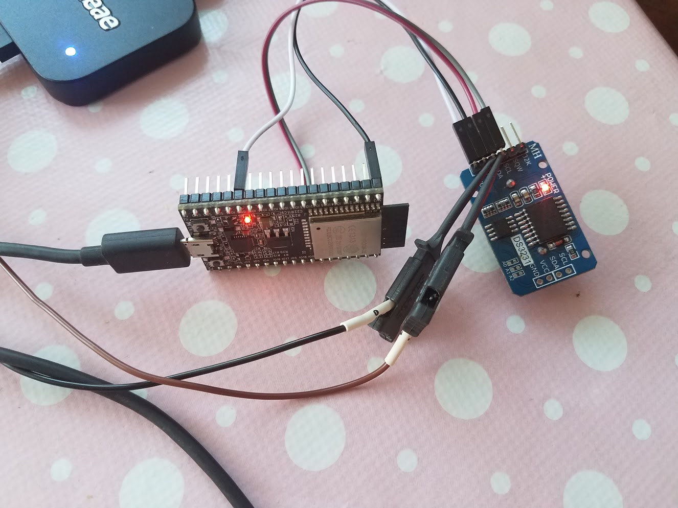

Wiring

First, your signal integrity is poor. Your oscillograph shows cross coupling signal lines at the edges. This is a symptomatic of improperly terminated I2C lines. Do both the SCL and SDA lines have pullup resistor? If not try connecting a resistor from each line to +3V3. Normally you can use a resistor whose value is between 1.2 K to 4.7 K. The specific value is not critical, but it must of the two lines MUST have a pullup.

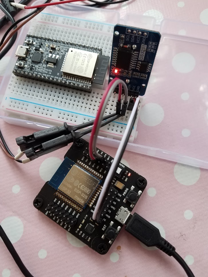

The board shown should have 4.7k pullups built in. There must be other signal coupling through breadboard, jig, etc...
Do you get same with your devkitc board?

Postby avsej  » Tue Jul 18, 2017 2:47 pm
Yes, same with devkitc, even when I connect it with jumper wires directly.

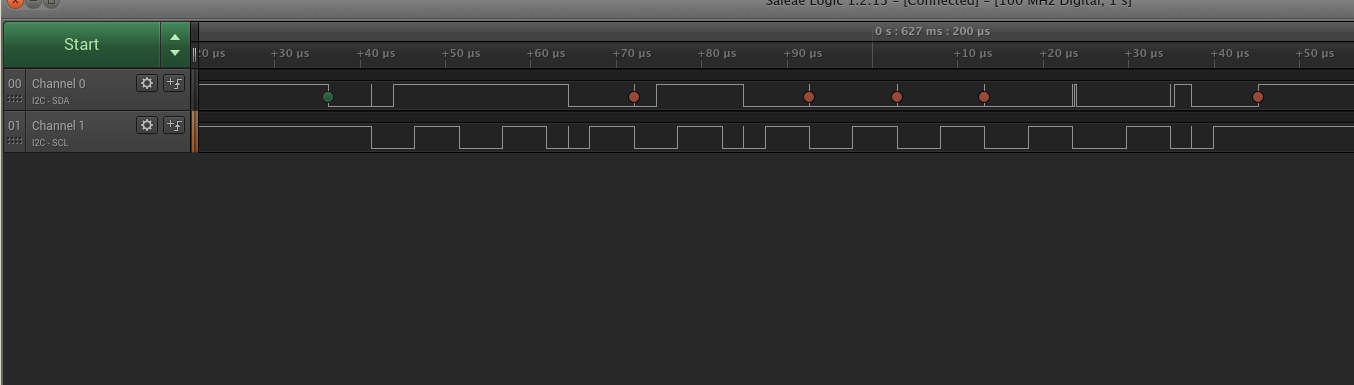

Okay. My problem has been solved :)
The test clips didn't give good connection. Once I connected without them, everything in capture became clear and without any glitches.
