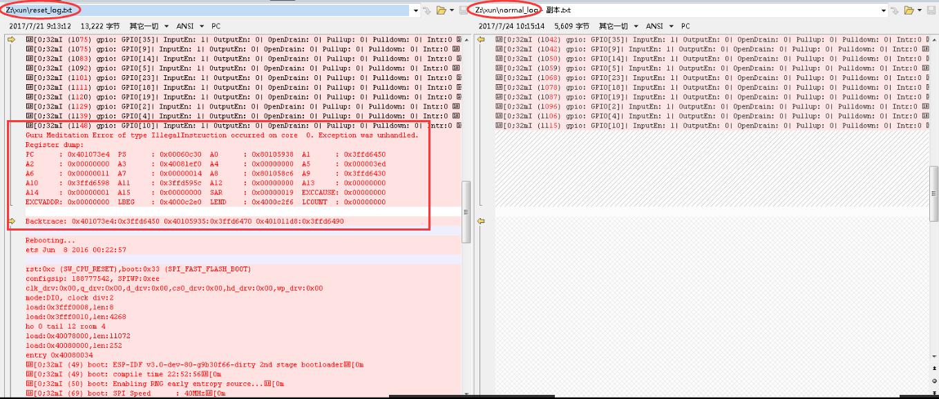

Thank you! I will try it as you say, but i want to ask if we can supply the esp32 d2wd in 2.8V@200ma? Because the ldo we select work in this voltage and ampere. Apart from you use the lab power supply, we use a battery and ldo to supply power for the esp32 d2wd.Can you suggest some suggestion for the esp32 d2wd? We are disapponited that when we supply the esp32 d2wd 3.5V 3.6V by the dc source but the chip reset reset and reset.But when we just provide the voltage 3.3v the d2wd can work well.

could you please offer the demo board of esp32-d2wd,or how could we get or buy the demo of esp32-dwd?
below is the reset compare to the normal log,please check the problem as soon as possible?
we confirmed that VDD_SDIO is 1.8V,and already pulled high for the pin of MTDI.

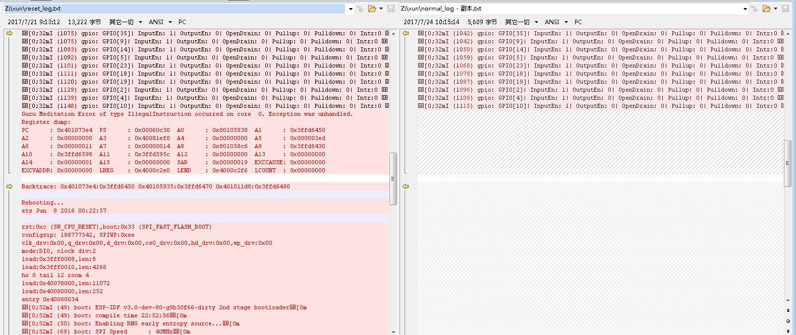

hi,i post the reset reset reset log.Can you help me to find the problem,Thank you!

I see you are configuring some GPIOs... which one do you configure after GPIO10?

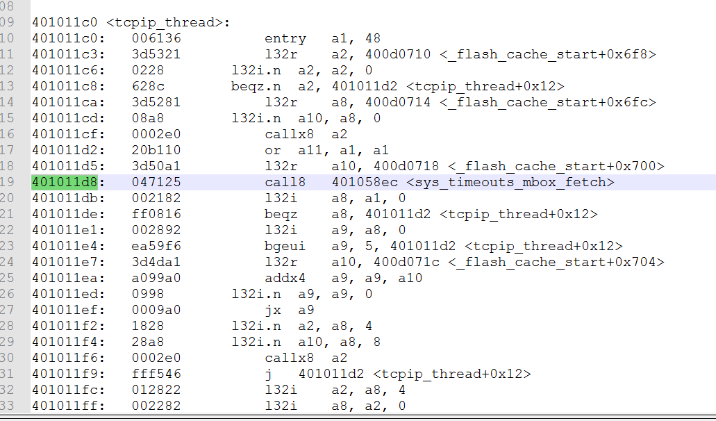

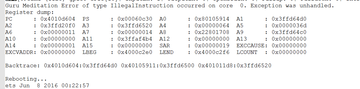

After configure GPIO10.GPIO is not configured any more.After configure GPIO10,"periph_module_enable(PERIPH_I2S0_MODULE)" is called.The followings is reset log and the dump file using "xtensa-esp32-elf-objdump -D -S developing.elf>dump".Could you please give us some suggestions by checking reset log and dump file?
