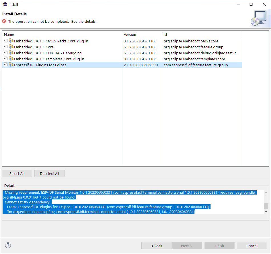

I am completely new to Expressif. I am attemping to set up the Eclipse IDE development environment with the Expressif IDF Plugin. I have followed the instructions verbatim (https://github.com/espressif/idf-eclips ... /README.md). Below is an error when attempting to install the plug in:
Cannot complete the install because one or more required items could not be found.
Software being installed: Espressif IDF Plugins for Eclipse 2.10.0.202306060331 (com.espressif.idf.feature.feature.group 2.10.0.202306060331)
Missing requirement: ESP-IDF Serial Monitor 1.0.1.202306060331 (com.espressif.idf.terminal.connector.serial 1.0.1.202306060331) requires 'osgi.bundle; org.slf4j.api 0.0.0' but it could not be found
Cannot satisfy dependency:
From: Espressif IDF Plugins for Eclipse 2.10.0.202306060331 (com.espressif.idf.feature.feature.group 2.10.0.202306060331)
To: org.eclipse.equinox.p2.iu; com.espressif.idf.terminal.connector.serial [1.0.1.202306060331,1.0.1.202306060331]
What am I doing wrong?

Just in case anyone is interested, here is the response from the IDF plugin developers.
https://github.com/espressif/idf-eclips ... 1724907394

We are working on a fix for this, please test this build update site and let us know if you're able to install on Eclipse 2023-09.
Here is the fix update site
https://github.com/espressif/idf-eclips ... /934280246
