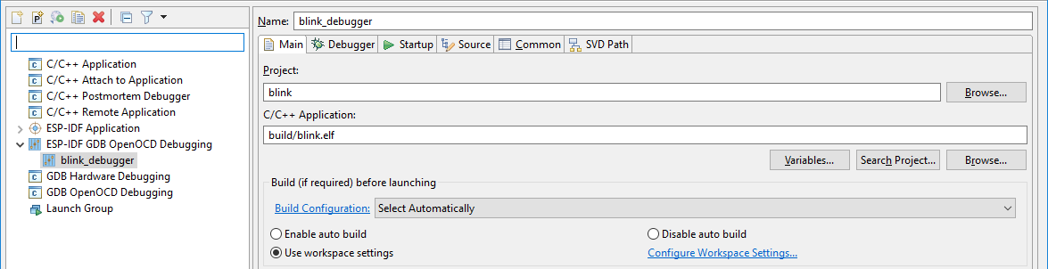

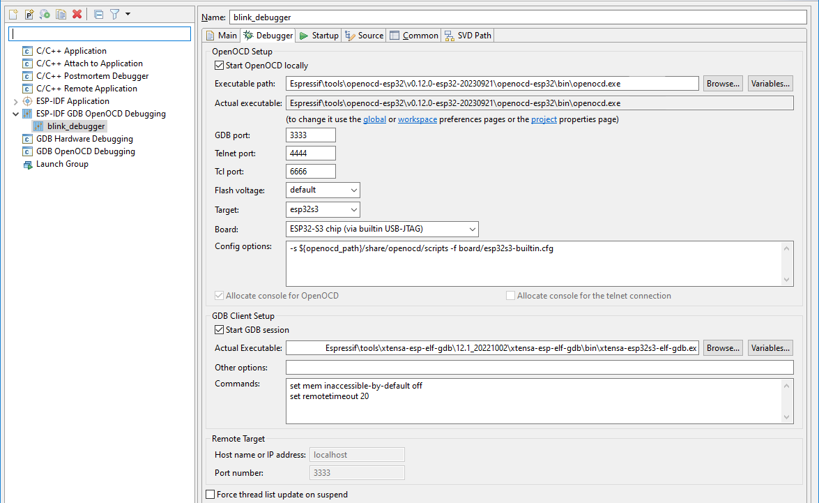

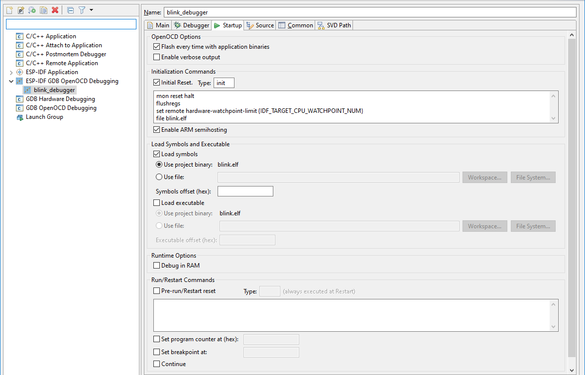

I can't start debug mode in Espressif IDE
Postby tankist » Thu Dec 07, 2023 10:15 am
I make a project in Espressif IDE from the scratch but use a pattern blink. Than I try to put my board ESP32-S3-Devkitc-1 into debug mode with onboard USB-JTAG. The process starts and I see the code uploads but the debug state is unexpected terminates.
Debug console log:

Settings of the debud mode:
Could you tell me what is wrong?

The main problem was with a stupid string in "Debugger" -> "Startup" section:
set remote hardware-watchpoint-limit {IDF_TARGET_CPU_WATCHPOINT_NUM}
I guess there is no information about IDF_TARGET_CPU_WATCHPOINT_NUM variable so debugger didn't work. I just removed the line and debug session has started.
