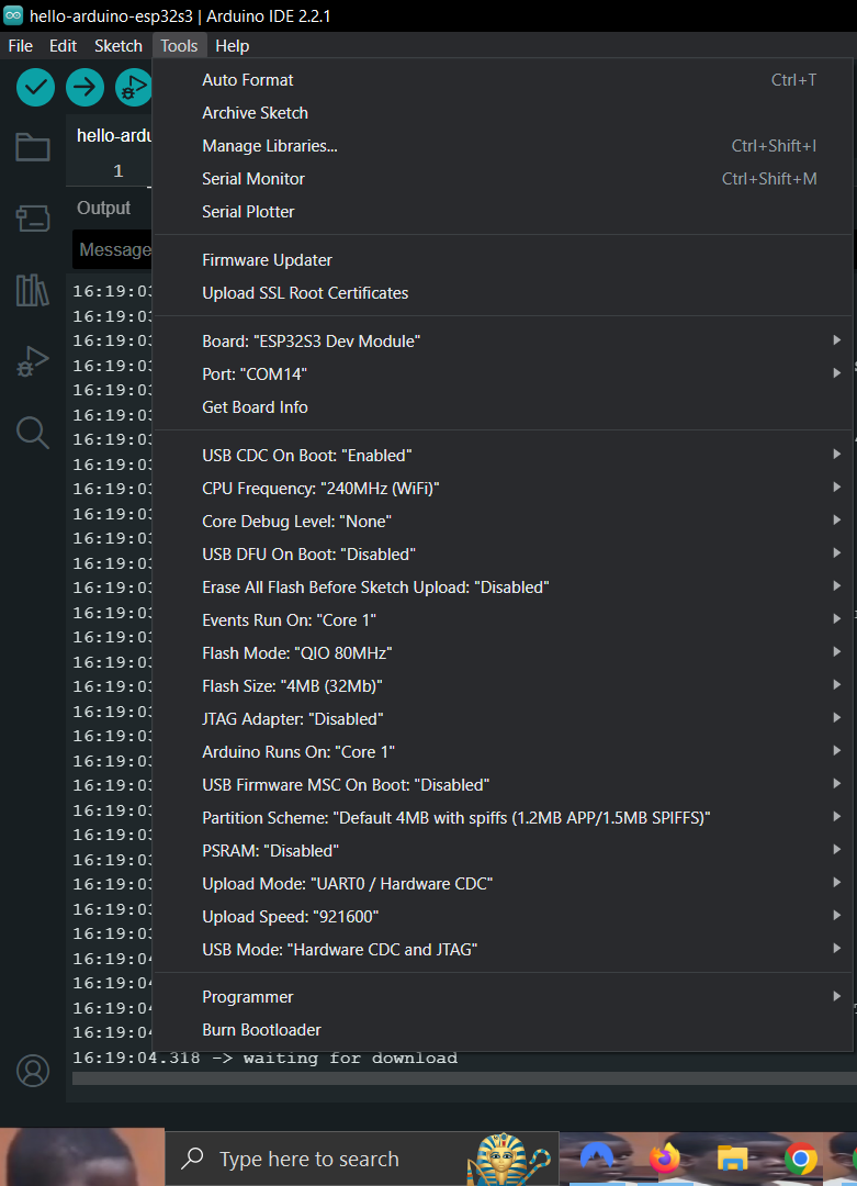

I've set the board preferences as shown in "Screenshot (470)" but I have no idea if that is correct.

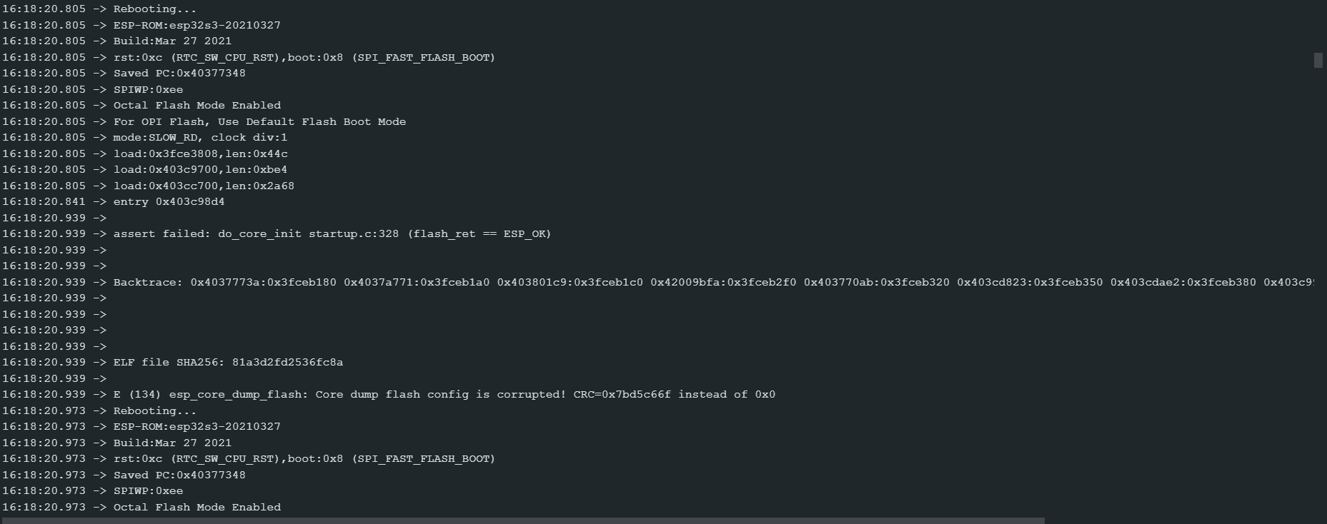

If I do not press any buttons I receive the messages shown in the picture "error messages"

- Screenshot (470):
Board preferences - Screenshot (470).png (131.14 KiB) Viewed 9042 times
- error message:
Monitor error messages when pressing no buttons - error messages.PNG (65.06 KiB) Viewed 9042 times

On ESP32-S3 devkitc, there are two usb connectors. One is labelled USB, and the other UART. If you use the UART connector, you should disable USB-CDC on boot. If you use the USB connector, you should have that enabled. I would recommend that you use the UART until you get your bearings. It will show you all the output, even in a reboot loop.
There are two models of ESP32-S3 modules. They are marked on the module. The WROOM-2 should use OPI flash (and OPI psram). The WROOM-1 should use QIO flash (and psram, if present).
You are uploading firmware to the device properly, so there is no need to add any capacitors or strapping pins.

SOLUTION:
1 Go to https://www.silabs.com/developers/usb-t ... umentation and download the CP210x Driver, (I have Windows 10 and used the universal Windows driver). Unzip the folder and right click on silabser.inf and select install. Proceed until download is successful. (What is this doing? This downloads firmware that allows the ESP32 to communicate with your PC via UART).
2 On the board connect to UART port, not USB port.

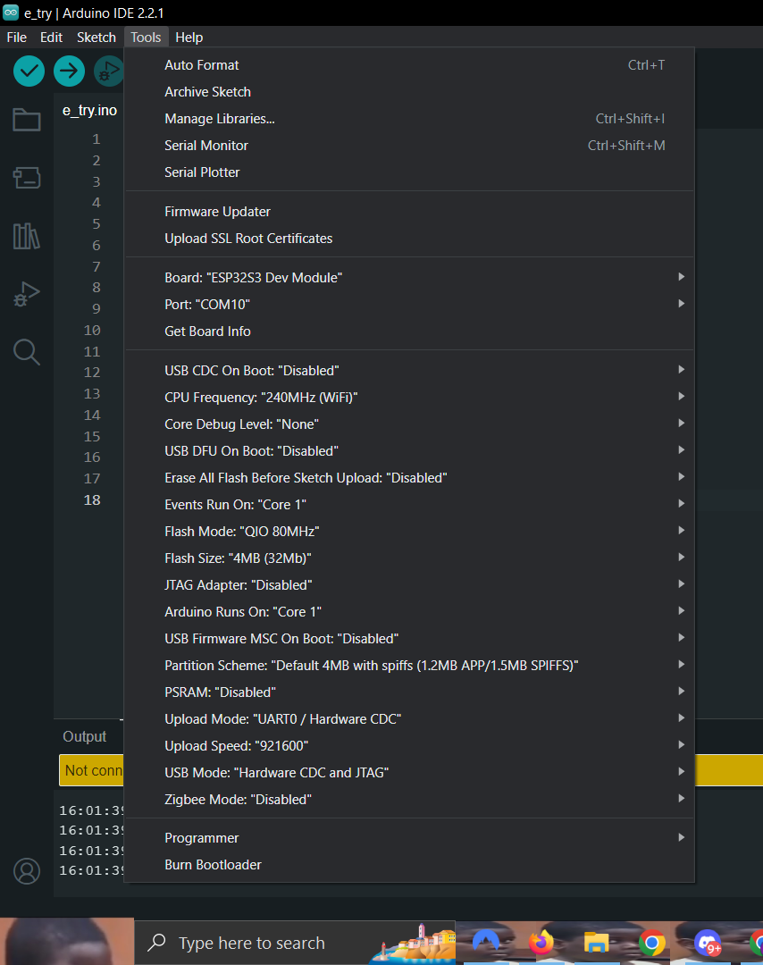

3 Match the settings in the picture. Choose the COM port that automatically appears. (If it doesn't appear, there may be two issues: 1. The wrong driver was downloaded, do some research to find what driver Espressif requires 2. Sometimes Arduino IDE does not automatically detect devices so try each COM port manually.)
4 Now you must prep it for programming. Open serial monitor, (double check your baud rate matches). Hold the BOOT button, press and release RESET button, then release the BOOT button. The serial monitor should say "waiting for download" or something of the sort.
5 Upload the code and it should work
