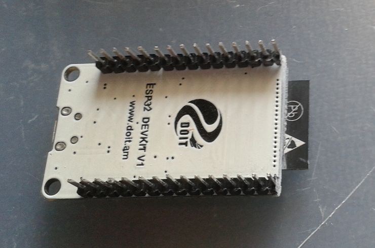

Using an oscilloscope I have measured current consumption of DOIT ESP32 DevKit with ESP-WROOM-32 module running Arduino WiFiScan demo sketch.
While executing WiFi.scanNetworks() function very first time, module consumes average current of 0.5A for 10 ms with four peaks of approx. 0.7A during that period.
After that module consumes average 130 mA with 0.6A current spikes. The spikes have duration of 0.5 ms and appear in bursts with spike rate of 100 ms.
Apparently it is about 2 times worse than promised in the ESP-32 data sheet. I expected to see about 0.3A max (50 mA for CPU and 240 mA max for WiFi transmitter).
Running ChipID demo sketch with WiFi off, current consumption is steady 50 mA, as expected.
Is it a problem of ESP-32 silicon or of ESP-WROOM-32 WiFi circuitry? Is it possible to get ESP-WROOM-32 modules with correct current consumption?
Update:
I have noticed that Espressif DevKitC has antenna hanging out of board. When I cut a piece of DOIT ESP32 DevKit PCB beneath antenna, the peak current consumption reduced by approx. 1/3
ESP-32 DevKit modified.png (778.62 KiB) Viewed 130818 times
Thus, apparently the problem was caused by incorrect DOIT ESP32 DevKit design.

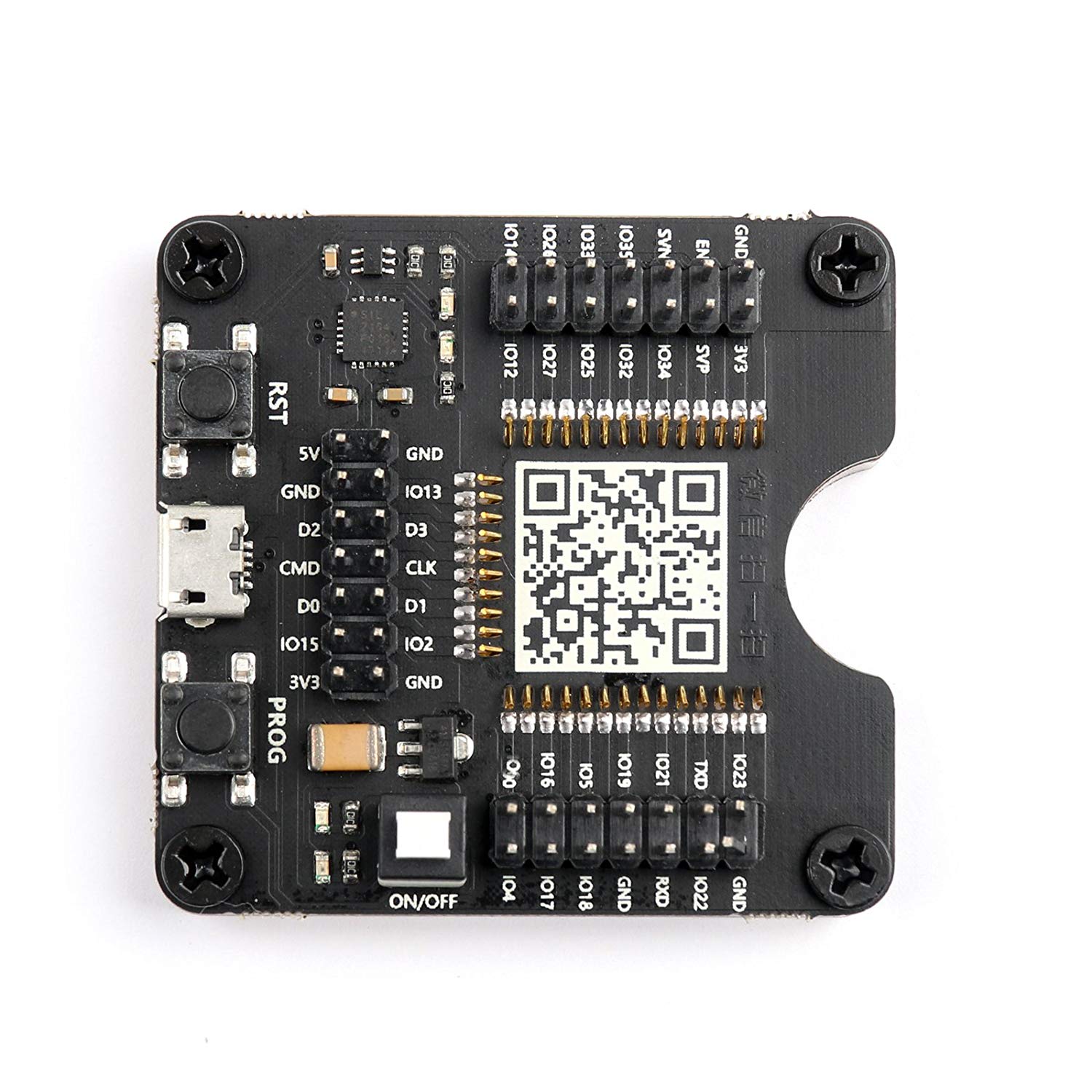

A better approach to testing current draw is to get a ESP32 Test Board. Like one of these. With the ESP32 removed test the current draw of the board alone. Then pop the ESP32 in there and subtract the new reading from when it was removed.
