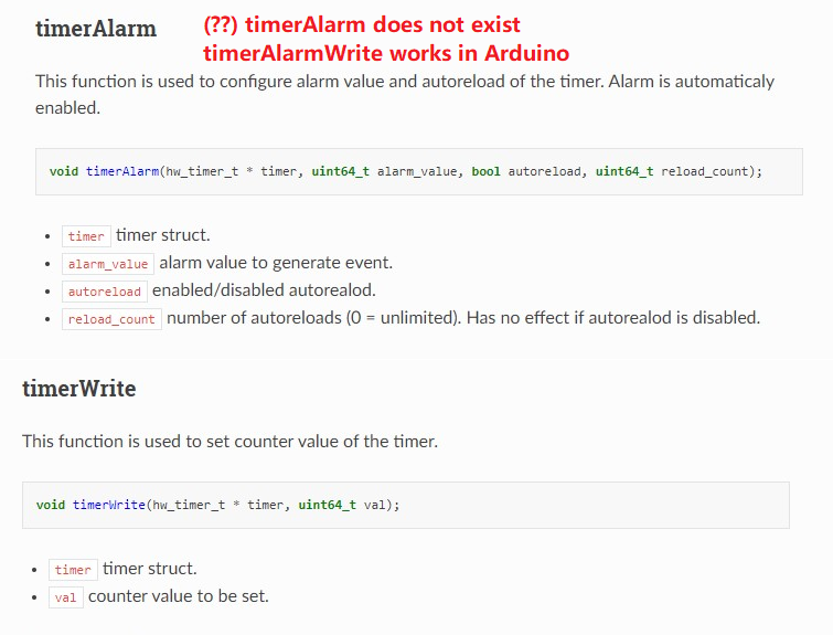

Hello, I'm facing some unexpected behavior regarding timers and interrupts. I'm hoping to get some insights or suggestions.
My intention is to use the timerWrite(timer, 50); function to set the timer counter to 50, then have it count up to 100, trigger an interrupt, and reset to zero because of the auto-reload feature. However, the behavior I'm observing is different. Once I set timerWrite(timer, 50);, the timer is counting only between 50 and 100 and does not reset to zero. It only resets to zero if I explicitly call timerWrite(timer, 0);.
Here is code for reference:

While it is weird, I think it is correct. Call timerRestart in your alarm function, or have a separate one shot timer that then starts the normal cycle for better precision.

I found this while rewriting library from AVR to ESP32. Once I figured out what the problem is I sorted it by calling timerWrite(timer, 0).
It is just make no sense to me because timerWrite is supposed to change just actual value of counter. If I would change the setup permanently I will call timerAlarmWrite and change alarm value. For AVR it is working as expected. This seems like bug or poorly documented feature

If you believe this does not match the Arduino standard, then open an issue at https://github.com/espressif/arduino-esp32/issues
