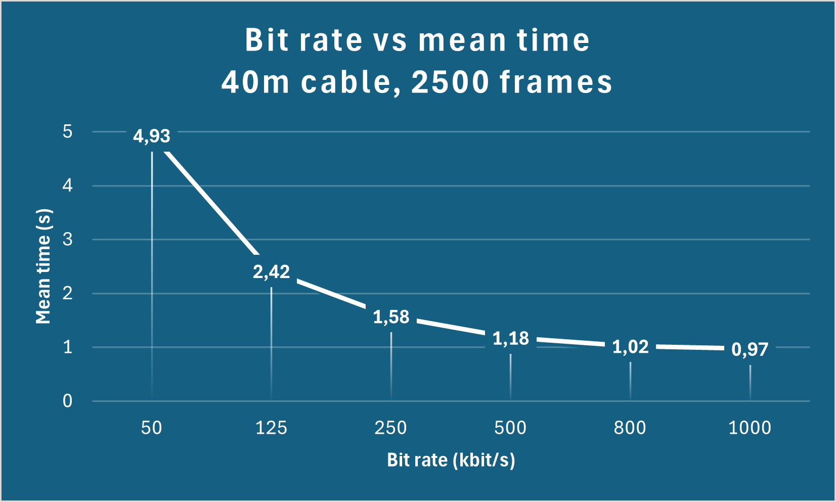

Siimsalabim
Joined: Mon Apr 15, 2024 6:08 pm
Re: Esp32 canbus slow at 1mbit?
Postby Siimsalabim » Mon Apr 15, 2024 6:25 pm
Well, I reverted back to the ESP32CAN library:
https://github.com/sdp8483/ESP32-Arduino-CAN
there is still a delay. I updated the miwagner to work at 1000mbits but it also has the same issue. I am stumped as to where to debug.
I'm experimenting with TWAI_MODE_LISTEN_ONLY but when I do that I receive the same data over and over.
Hi, as it happens I am currently writing my Bachelor's thesis on CAN bus for home automation and ran into similar findings. So I had to make an account and join the conversation :). I was testing the bus speeds with ESP32 and a custom transceiver module with the SN65HVD230 which resulted in the chart below. These times are however with some overhead of starting and ending the communication session with some back and forth frames. I just went back and confirmed that it adds about 0.25 seconds across the board. But since it is a constant overhead it doesn't affect the result which is that I got diminishing returns starting from 500mbit/s bit rate. I think that probably the controller is not up for these higher speeds because the transceiver is built for 1mbit/s rates, but since I do not have time to confirm this it will remain hypothetical for now. I would be interested if you get something similar, however, if you have time. Would be interesting to compare.
