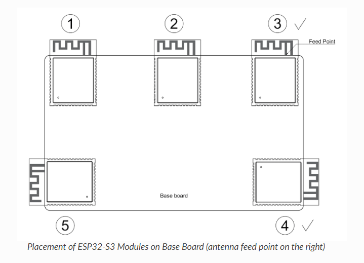

Hi
I can find information of antenna placement for onboard antenna like attached. But that is for onboard PCB antenna. For IPEX I can't find anything similar. Maybe I have missed something?

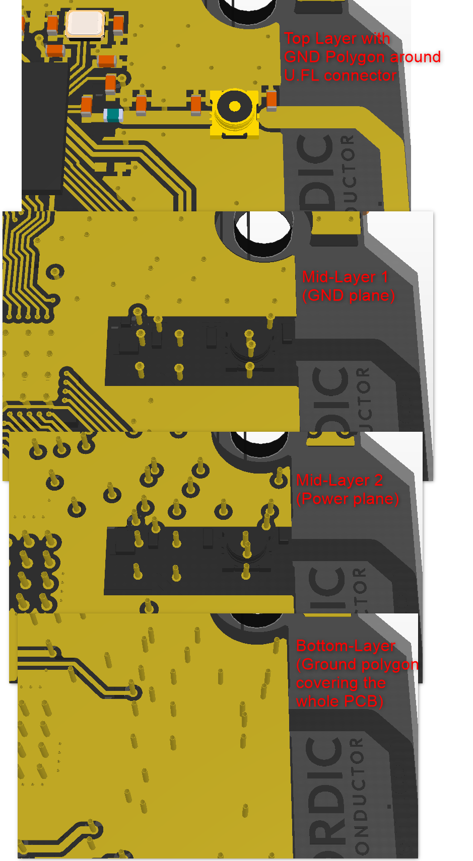

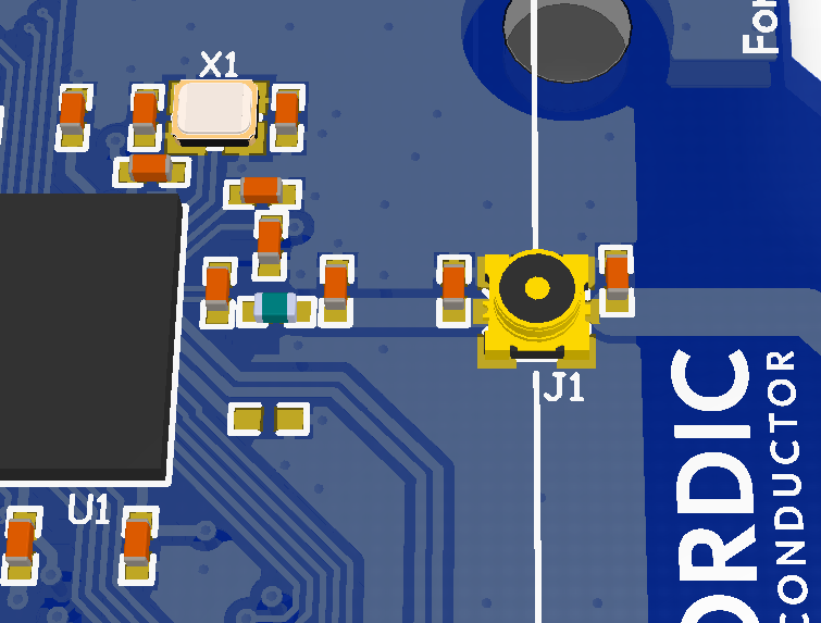

Hi
There is an indirect information borrowing from Nordic's nRF52840 EVK. Its layout is open to the public(in Altium Designer format). Attached please find two screen captures :
1. File "Nordic_nRF52840_EVK_Layout1.png" shows the normal 3D view. There is a ground polygon pour around the U.FL connector.
2. File "Nordic_nRF52840_EVK_Layout2.png" shows the 3D view with all 4 layers combined in one picture. There is ground cut-out for the 2nd and 3rd layers. The interesting part is on the 4th layer which shows a complete ground pour without any cut-out for the U.FL connector.
My guess is that: when the EPS32 S3 MINI 1U module is placed on a PCB (baseboard), there is no longer required to define any cut-out under the IPEX connector because the module itself has the necessary cut in the module itself. The U.FL/IPEX connector guarantees that it is a 50Ohm co-axial cable and connector structure to connect to an external antenna no matter there is a ground plane under the module or not.
Any body has experience/comment on it?
John
