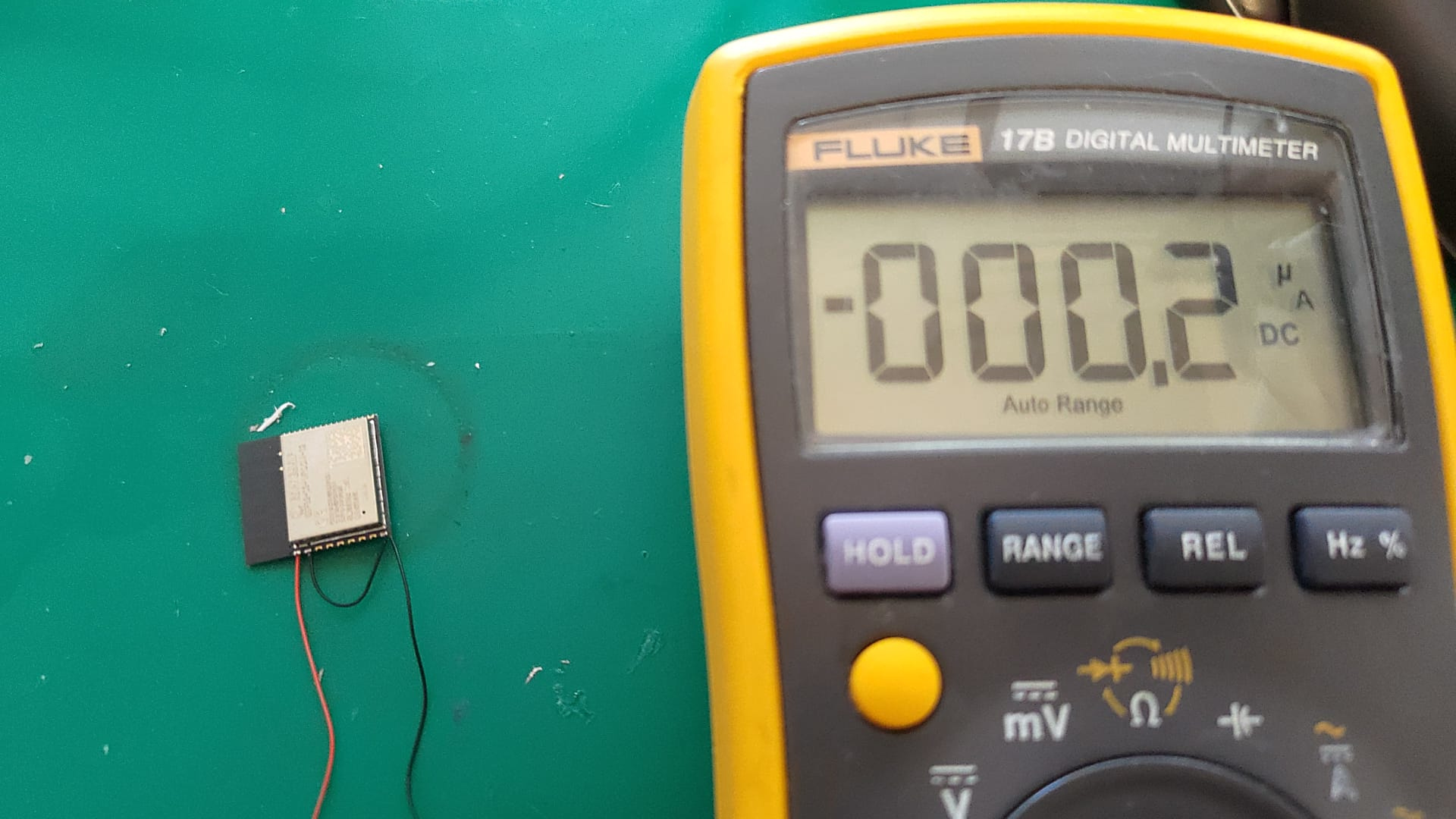

Postby Sprite » Wed Mar 27, 2024 1:49 am
For reference: this is an ESP32-C3-Wroom-02 (containing the same ESP32-C3 chip) when held in reset. I measure the fraction of an uA that I'd expect.
